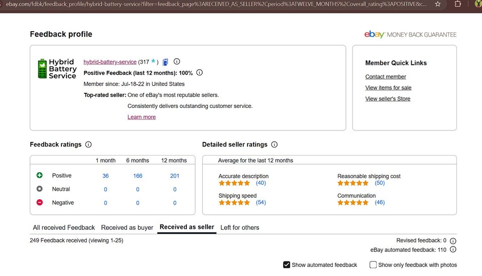

  17. Smychnyk
    Smychnyk New Member
    Aug 12, 2025
    UA
    I understand why many people are skeptical about rebuilt hybrid batteries. There are a lot of scammers in this market who don’t actually rebuild anything and instead sell old batteries — either not tested at all or only very superficially tested — as “high-quality rebuilt” units.
    Of course, there is also the option of buying new Chinese batteries, but they come with their own drawbacks, which people often discover only after installation.
    That’s why, when it comes to rebuilt original hybrid batteries, there is still real demand for them — and not a small one. People do buy them once they understand the difference between proper rebuilding and simply reselling old, worn-out batteries.
    For example, Hybrid Battery Service. I don’t know the exact number of batteries they sell through their website or other marketplaces, but even judging only by eBay reviews, they appear to have 30+ sales per month.
    The price on their website is usually lower than on eBay, which makes sense, since the platform charges a fee of around $150 per sale.
