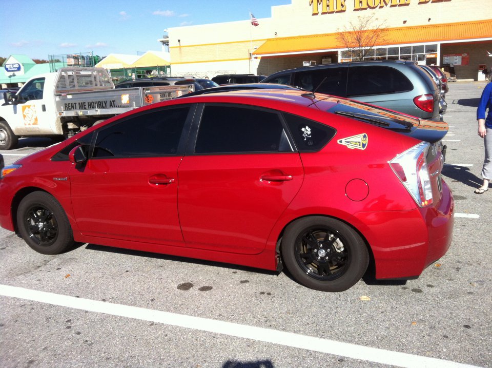

    Does this count as ever having driven a lowered Prius?? She was hurtin on this ride but handled it fine.

    I guess but it depends what you are after? if the squat look with your headlamps pointing into the sky.. sure.. not to mention it will ride terrible.
    I prefer the even or slight rake look myself... which is opposite to this..

    My sarcasm didn't come through obviously. Hahaha!!!
    I overloaded the hell out of the prius that day and had to snap a couple pics... Who needs a pick up tk. Lol.
    She was def slammed though. :)

    So was I.. slammed isn't same as sqaut though.. (y)

    Gotcha! Yes she was squatting like a dog..... It was rediculous....
