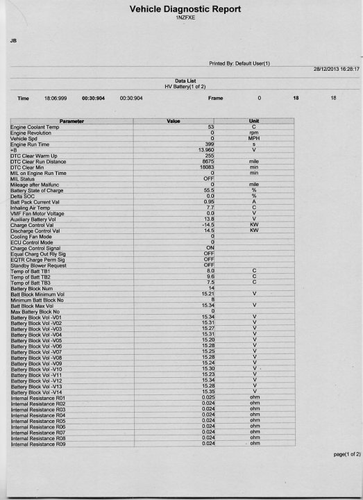

    Shown below is one page of two of HV battery diagnostics from the Mini VCI from my Prius to give you a flavour of what to expect.
    John (Britprius)

    John,
    Thanks. That 's the kind of detail I want. This will recover stored error codes as well, correct?
    I'm already pricing this on Ebay........
    Ed

    Yes, it is as close as you can get to the dealer diagnostics. If or should I say when you get one you will be amazed at the level of functions. It covers all Toyota's and will do emissions related work on other vehicles.
    John (Britprius)
