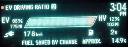

    I have used sta-bile for lawn mowers but I’m not so sure about a Prius. Owner’s manual clearly states to use at least ½ the tank every 6 months (refuel at total of at least 5.3 gal. (20L) of fuel every 6 months). GM recommends premium fuel for Volt since they anticipated low gas use with Volt’s range and felt premium fuel would stay stable longer. I’m currently averaging a gallon per month and I’ll go well above that, especially in summer, but I'm wondering how Toyota decided that a gallon per month of gas use was adequate? They are effectively saying that gas can be left in the tank for a full year (admittedly mixed with newer fuel) and be OK. Anyone else think that’s questionable? Owner’s manual indicates it doesn’t matter if I add a gallon a month or wait and add 6 gallons after 6 months as long as I don’t wait longer than that. Is one approach better than other? I will take at least one very long trip each year and fully refuel tank and probably trips well out of EV range every 3 months or so. So, I’ll easily meet owner manual requirements. Still, I wonder what long term impact on ICE is if I routinely barely beat the requirement over long stretches year after year? Will I have a like new engine with only several thousand actual miles after 5 years or one prone to problems from infrequent use and running on years of stale gas?
    To demonstrate this being a real concern, here are my results after my first 2 months of Prius use with 9 mile commute to work, max speed of 50 mph, ability to charge at work, and with kids now in college, and many activities and stores mostly in EV range. Yes, I know I just need to get out more but that’s more often in summer than winter.
    (I reset Trip A on last refueling but didn't reset EV ratio at same time). I bought PIP in Maryland during an east coast trip I was making anyway and drove it back home to Indiana. Above are my stats since then. My first 900 miles was mostly HV and at least got through much of engine break-in. It would seem to me breaking in the engine with only a warm-up cycle every 124 miles along with some occasional additional short use would be even worse. So far, it hasn’t gotten cold enough here to use ICE for my garage to garage commute, so I've only used ICE for longer weekend trips. I chose PIP over Leaf/Volt because it was lower cost, even after tax breaks, and met my range needs. I also better trusted Toyota reliability and preferred to eliminate any range anxiety concerns. Effectively, adding an ICE was lower cost than additional batteries in Leaf and I won’t be using either that often. I haven't posted my mileage stats yet as I'll have a few more months before I'll need to buy gas!
