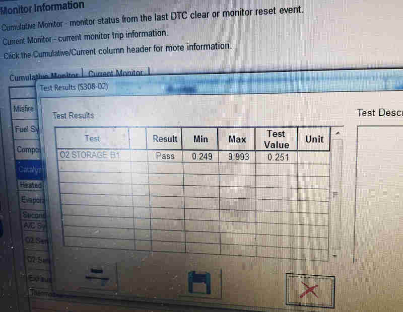

    The car itself tests the catalytic converter regularly, and keeps track of its "oxygen storage capacity", and you can ask the car any time what the OSC was in the most recent test.
    More oxygen storage capacity is better. In the car shown above, the tested storage capacity was 0.251. The minimum to pass the test is 0.249, and when the tested OSC drops below that, a P0420 code will be set and it will be time to replace the cat.
    0.251 might seem to be pretty low, close to the minimum passing, but it does not seem to drop very fast; that was my test result from 2½ years ago and I don't think it was any worse the last time I checked.
    I have not seen what the typical OSC is for a brand shiny new one.

    Yeah, mine is 0.22xx, close to minimum but it sits in that range for last 3 years since I monitor it. :)

    I guess my cat is good then. This is what I was able to find. I did notice my catalyst temps 1 926F and 2 828F. Hopefully that's a normal amount. I assume that's the oxygen sensors before and after the cat.

    On August 1, my "OSC" was reported as 0.252845, compared to 0.249795. I'm not sure what units apply, or why they show so many significant figures. It's not burning much oil.
  15. ChapmanF
    28,705
    19,006
    Just depends on the scan tool you're using. It gets the numbers in binary from the ECU, and converts them to decimal using the math that is specified for that PID, and in the case of your scan tool it's doing that the way your middle school science teacher wanted you to stop doing on your calculator.
