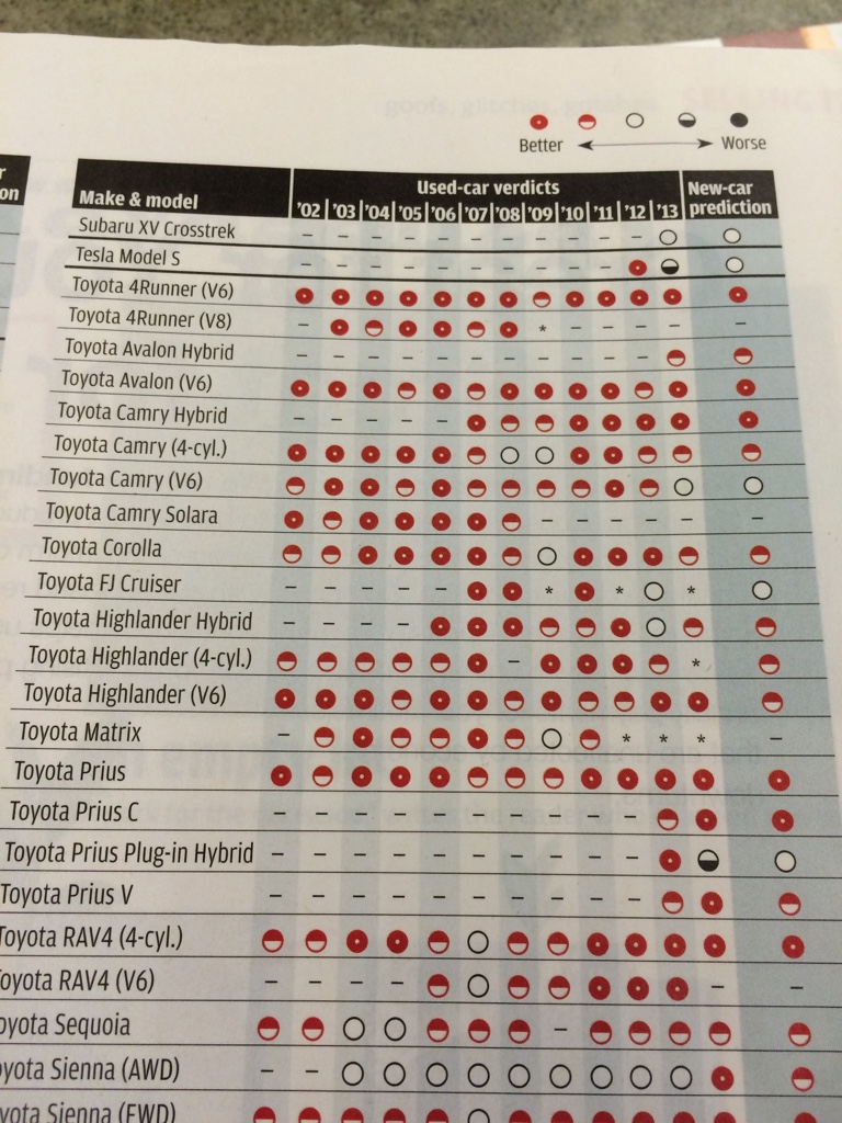

    So... You also read the post AFTER buying the car eh? Well, I have to remind myself I did research this car, just not this forum. I actually went to the library yesterday to validate that I wasn't crazy and that consumer reports STILL recommends Gen 1 base on their consumer surveys.

    Agreed, but my limited research indicates that is one of the most reliable 13 year old vehicles on the road. This report is from 2014
