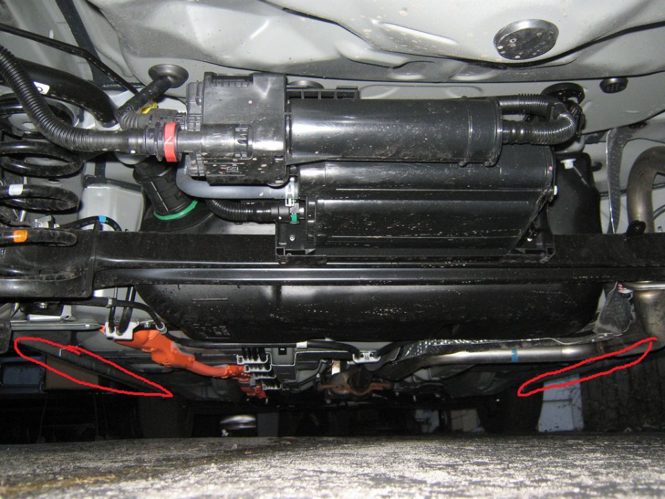

    Do you guys notice the orange electric cable under prius c's body? I think those are the cable from the battery pack to the engine bay. Any concern about those cables on rough road or snow day... Sounds risky but I think toyota thought about that already.
    I found one pic on google. The orange on the left is the one I am talking about and it looks like plastic pipe.

    All the Cs have that. Ive had my for almost 2 years and not one problem with it going thru snow and rain. I recently examined the orange cable when I installed my chassis brace and did not see any type of wear and tear on the wiring.

    That's not so much cable as sheathing, robust looking too. And yeah, Orange is code for the hybrid system wiring.

    If you punctured the insulation it most likely would create a Ground Fault. The system has a GF detection system that would generate a DTC and safely shut down.
