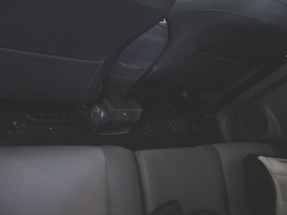

    It was one of my many cons when shopping for a car. The things I did like in the C-max where the steering wheel, the many air vents, dual climate control, the blind spot mirrors and the air vents in the center console for the rear passengers, the optional lift gate and it felt like it had more power over the Prius v with a higher EV control (which really doesn't mean anything but cool.)
    Buttttttt.....my wife could not get the cmax seating high enough for her 5.1 inch frame so Prius v in the end won.
    So I bought a $20 fan sad but true to boost the air flow in the back cabin and ran the 12v wire under the floor mat and behind the rear seats to the 12v plug in the back.

    52,822
    how many more sq. feet than hatchback? same size a/c system and fan? mine throws so much frigid air it feels like it would work fine in a much larger car. but i'm not in a hot climate.

    Is the airflow really that bad? There are actually vents under the front seats for the rear passengers, no idea how good they are as i've never ridden back there.
    Most of my riding is alone but occasionally have had a car load of 4 adults and no complaints from the back seats, maybe they were just being polite. :)
    I leave Climate control on auto and set to a comfortable temperature. I have noticed I have to dial the temperature lower with more people in the car to maintain same comfort as single driver setting, no biggie, just turn the dial.
    Only car I have to compare to is my previous Honda Fit. That car had a large interior space(for its class), lots of glass and a weak AC system, so I did notice with the Fit it was hard to keep it warm in the winter and AC could not keep up on the hottest days of the summer. My new v despite the larger interior space has no such issue keeping warm at -30*c and cooling nicely at +28*c.(hottest and coolest days i've seen yet)
    As always YMMV.

    Well here in Tampa June means 95-100deg feel like temps...it takes quite some time to cool the cabin and if a vent is not blowing on you then you feel hotter. Even with the tint and being that I keep it in the garage it makes it just bearable but in a direct sun parking lot...forget it.
    The cabin space is a lot bigger! The hatchback.... 21.6 cubic feet with the seats up and on the V 40.2 cubic feet. Folding the rear seat takes cargo on the V to 67.3 cubic feet.
    I sit with the driver seat back and it covers the pathetic floor air vent but I guess it goes with the territory for owning the biggest cargo space to mpg ratio ride on the road.

    Compared to my old 10' Prius IV, I've notice my new v cools down very quickly. I believe the hvac system in the v has been uprated from the liftback. The fan seems to move a higher volume of air.

    I am glad that I got to have felt what REAL ac was in the older cars but today's green tech it seems to be a lot of hot air being blown around! ;-)
    If I could I would put a ceiling fan in the cabin but this little fan I bought really makes a difference taking the what little air that comes out of those vents (only when you have the up/down selected) on the floor and shoots it up where it is needed the most.

    Pretty sure those floor vents are for air from the front floor vents, as in heated air or any air directed to the floor. You can get some cool air from them in the "bi-level" mode too.
    The outflow air vents for the entire cabin are in the back by the rear door on both sides, so setting the "re-circ" to off should blow cool air all the way to the back. One of the real shortcomings of the v's A/C system is it's default re-circ setting, which cuts off air to the rear of the cabin.

    Yes, SUVs and mini-wagons take longer to cool down. More cubic feet, more glass.
    Happened the same with my CRV. Where my Porsche cooled immediately with so many fewer cubic feet to cool. Move to a mini-van and there is a reason for dual a/c units.
