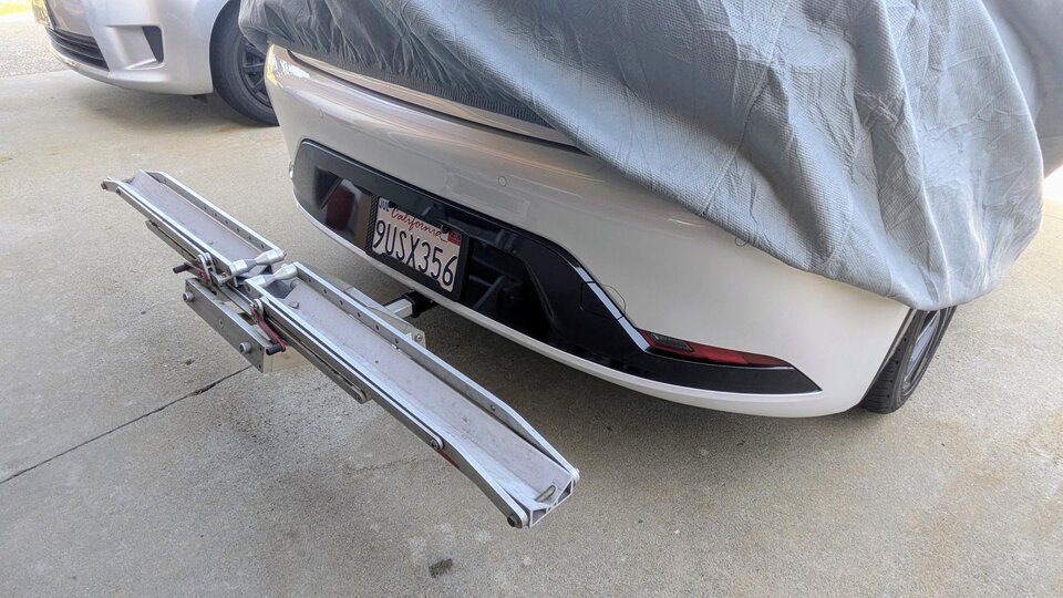

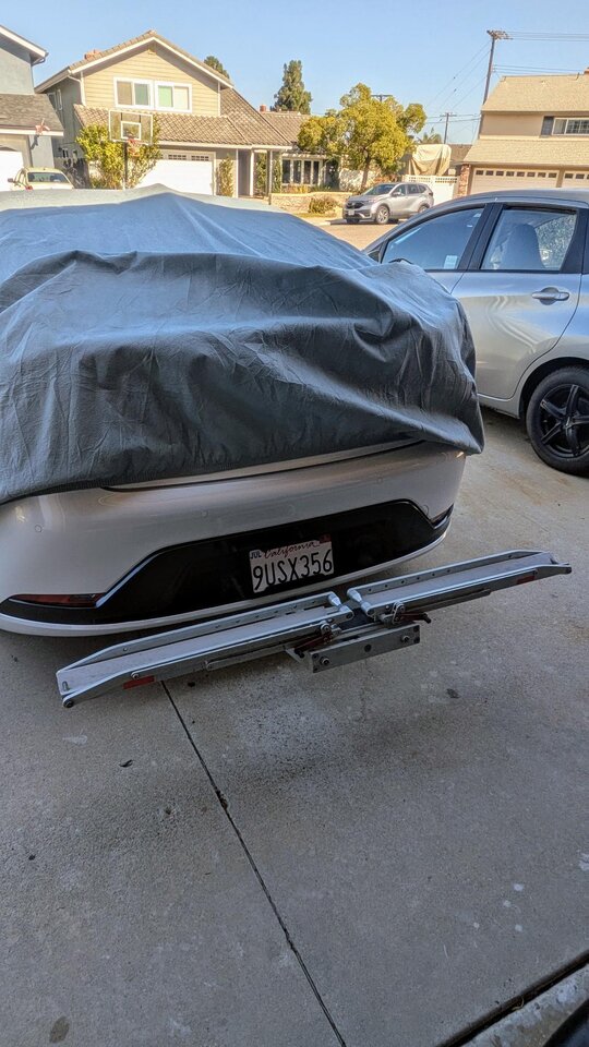

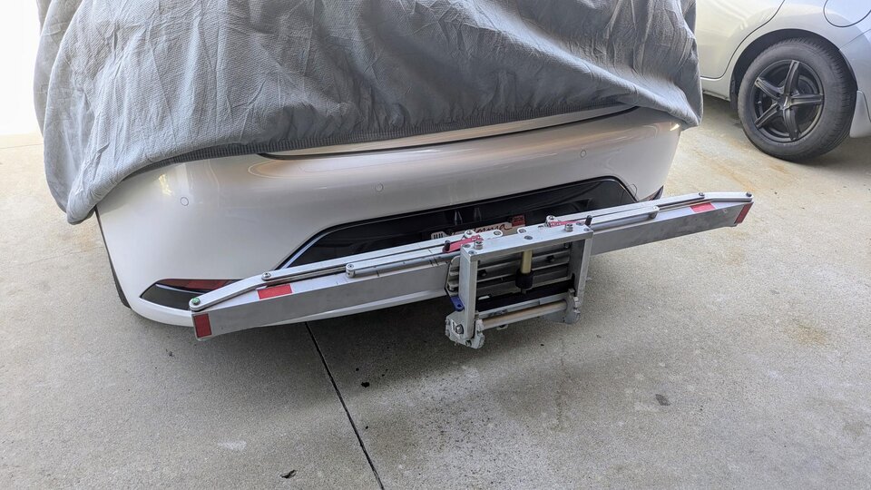

    Agree! I can add a second bike "tray" when I'm giving someone else a ride or need to carry two of my own bikes.
    Also, I can add a hitch mounted luggage tray when I need to carry extra luggage, or something with awkward dimensions.

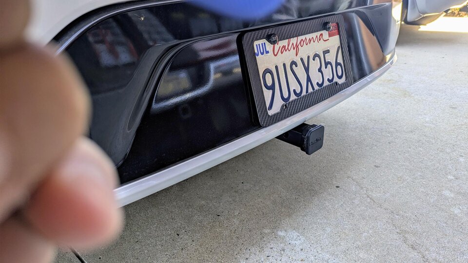

    Yes, that's a single tray shown. I have two more that bolt on for a max of three for a a 1 1/4" hitch with a tongue weight of 200 lbs for this particular brand of bike rack, which is a "1-Up".
    The hitch is not quite a bolt on affair - some minor mods required to the frame hole where the hitch bolts to, and some trimming of the fascia under the bumper. Took me about 1.5 hours to complete taking my time. do not know how that impacts insurance. I'm in California and don't think that's a problem here.
