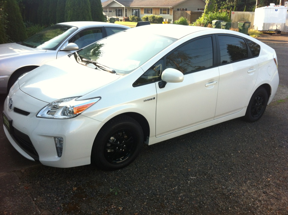

    I ordered the center caps and then scuffed them with a scotch brite pad and painted them with Krylon Fusion plastic paint they turned out great![​IMG]

    I bought the toyota center caps with the toyota emblem off the bay (2009 Yaris ones which should fit based on measurements). I plan on masking the shiny chrome toyota raised emblem and painting the recessed background black for contrast. I will post pics once I get them and do the paint job.

    Chrome Centre Caps (either Toyota or third party) might look good as-is: chrome-on-black. Or just following post #20 will save you bucks.

    I originally intended to remove the paint from the toyota emblem but kind of like the all blacked out look now. A word of caution if you are using Krylon Fusion -- It works amazing on the plastic and STICKS so if you get it on parts you don't want there is a good chance you won't see the chrome again.
