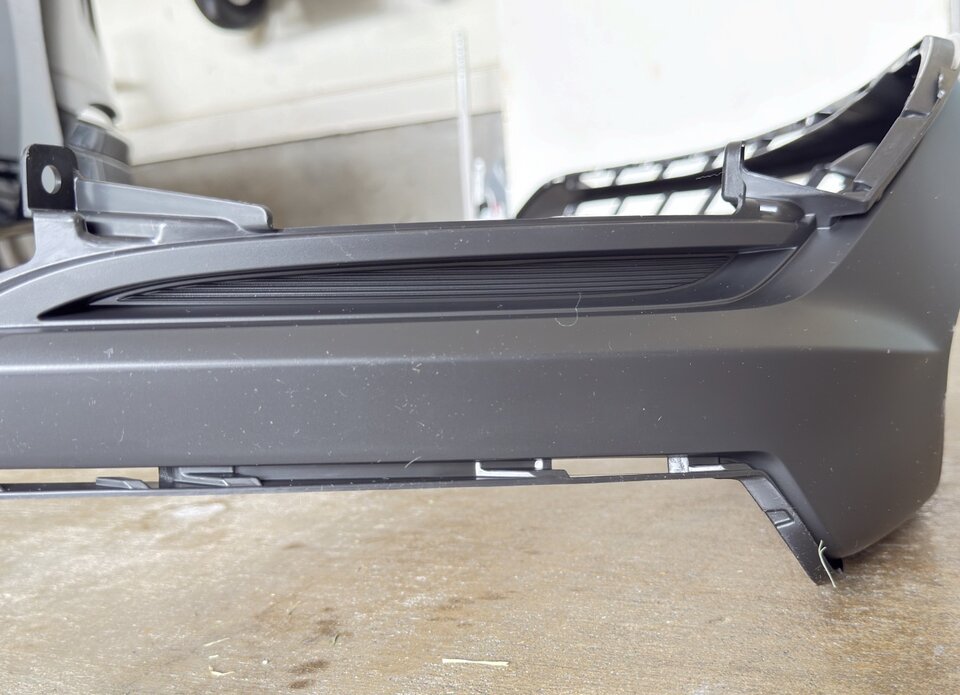

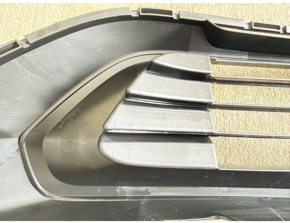

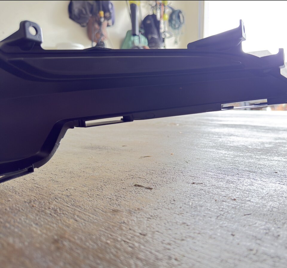

    How does the grey piece get removed? I accidentally ordered the LE grille to use to replace the silver one on my limited thinking I could just pop out the “middle” piece to not lose my fog lights, but I’m not seeing anywhere that the middle piece comes out of the larger piece.

    I'm just curious, can you confirm that the fog light covers are molded into the LE grille and not separate pieces that are screwed into it?

    I’m not seeing any type of cover or plate with screws or clips for the fog lights. Also included an image of the back side of the grille so those trying to swap from silver to black can see that the center piece (unless I’m missing something) isn’t swappable.
