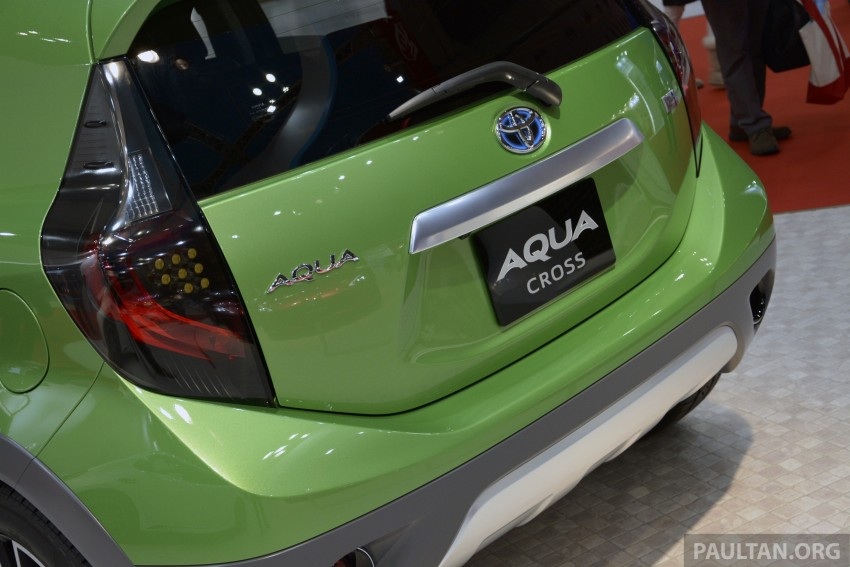

    . What brand are these lights? Are they the Aqua lights over in Japan?

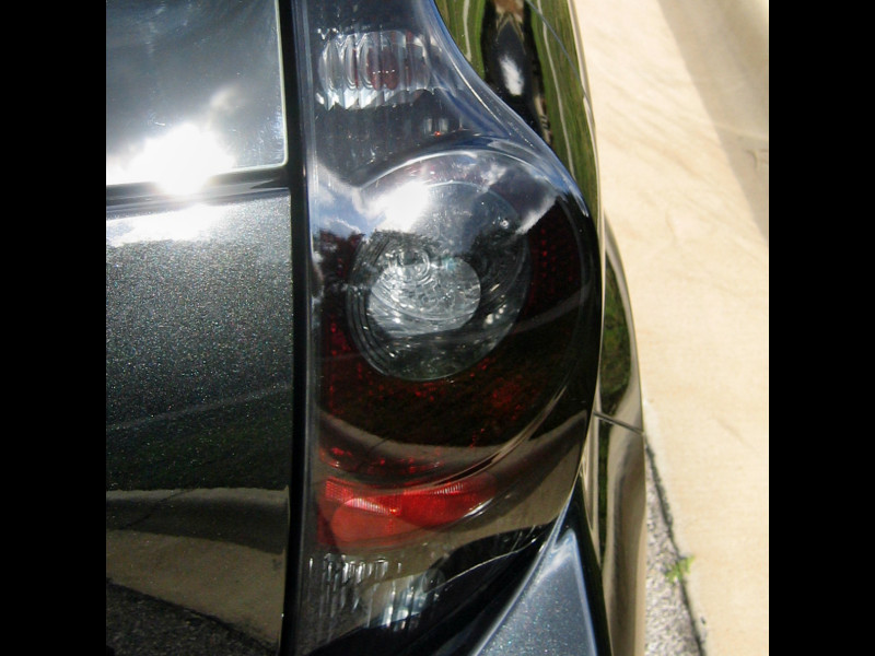

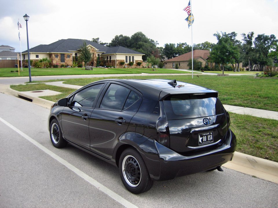

    OK, These OEM tail lights are NOT blacked out, but tinted with VHT Night-Shades spray paint and then polished with meguiars 105. The sides are painted with body matched paint. You can easily see the light bulbs in the 'windows' that I masked off. If you can see the unlighted bulb, you should have no difficulty seeing it when it is lit. RIGHT? From a distance the rear of the car looks integrated without the garish chrome monstrosities Toyota provides as standard.
    I'm not bothered by the center stop array, so it remains un-tinted. I don't feel this set up endangers me or anyone else.
