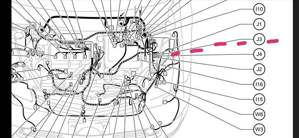

    I'm still trying to figure out how to fix my prius. Double check voltage at Transmission Control ECU connector and noticed that there are 10.4 loopvolts only. Voltage verified at IGCT relay = 12.3 volts. Based on wiring diagram there is a Junction connector J3. Do you know if this junction is located inside the car behind instrument panel??

    That's actually pretty interesting question to me in the diagram in the manual for the 2009 model publication em10qou green cover with chips on the front of it it looks like j3 is in or under the fuse box j3 looks like a 12 pin connector and if that's the case it looks like where the fuse box tapers down to the skinny right at the very top of that it looks like it's plugged it's a plug that goes right into the bottom of the fuse box so it must light up The pecan fuse which by the manual lights up two circuits I do believe I have to go back and look

    Blow up that picture real good on your phone you see what I'm talking about see where the fuse box curves right there starts to get skinny or the lid does or the whole box but you know what I mean that's where j3 is pointing to now I have a fuse box it's cut out of a car I'm going out to look at it now to see if j3 is marked on the bottom of the fuse box or something or that connectors there the car is sitting 200 ft away
