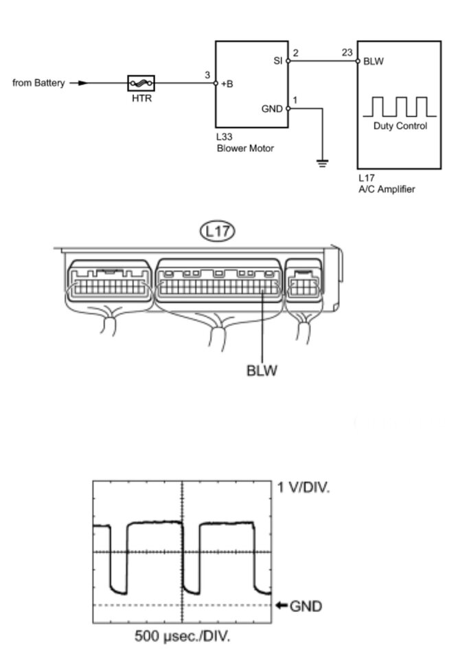

    First thing I would suspect is the replacement blower motor is bad. Unless it was new oem.
    I would check three fuses

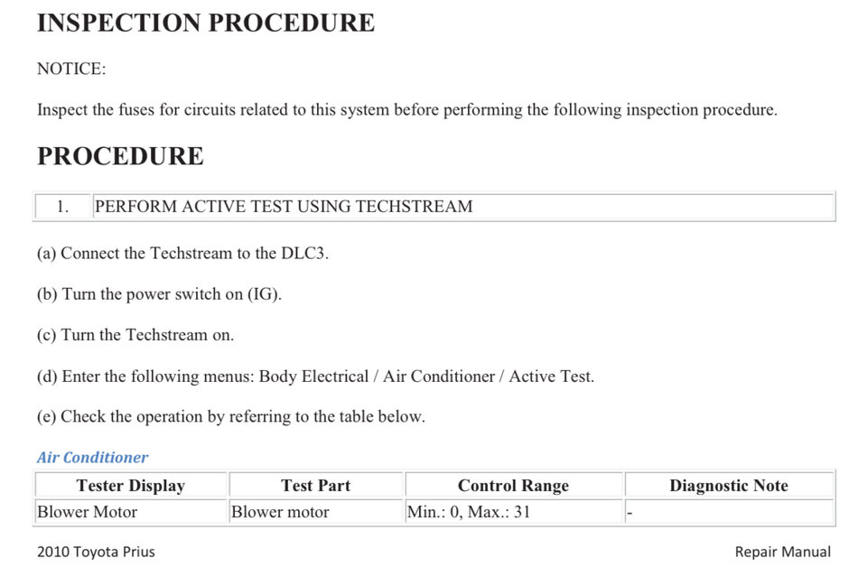

    Then do an active test with Techstream if available
    Then check power and ground across the blower motor itself to ensure power and ground are good. A bad ground is just as bad as no power.
    Finally you need a scope or meter with graphing capabilities to check the SI pulse train input.
    If the replacement blower is not new Toyota oem from Toyota then my bet is it's bad.

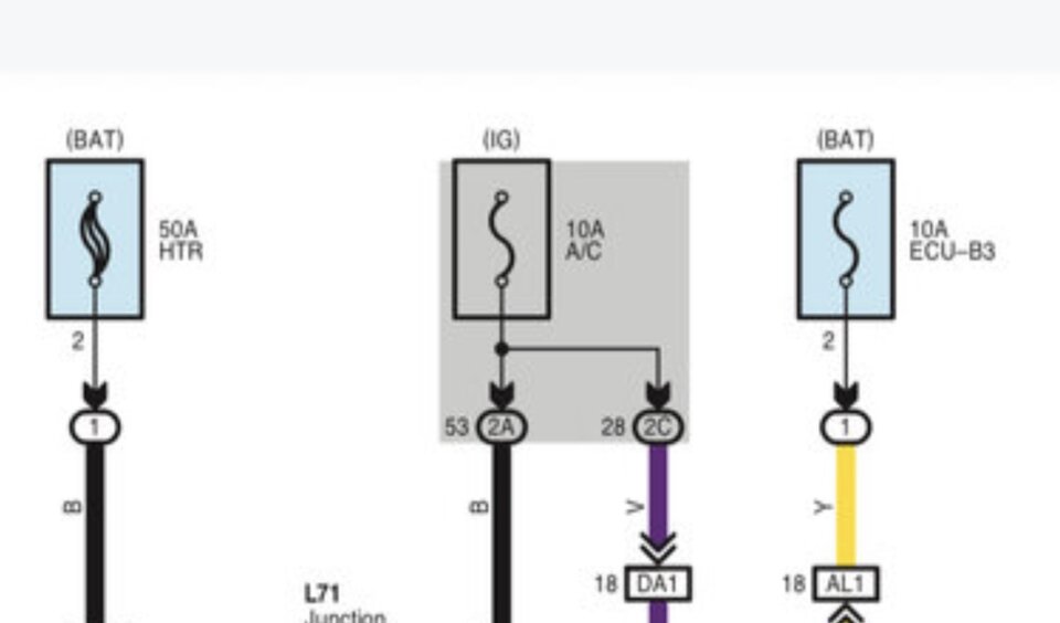

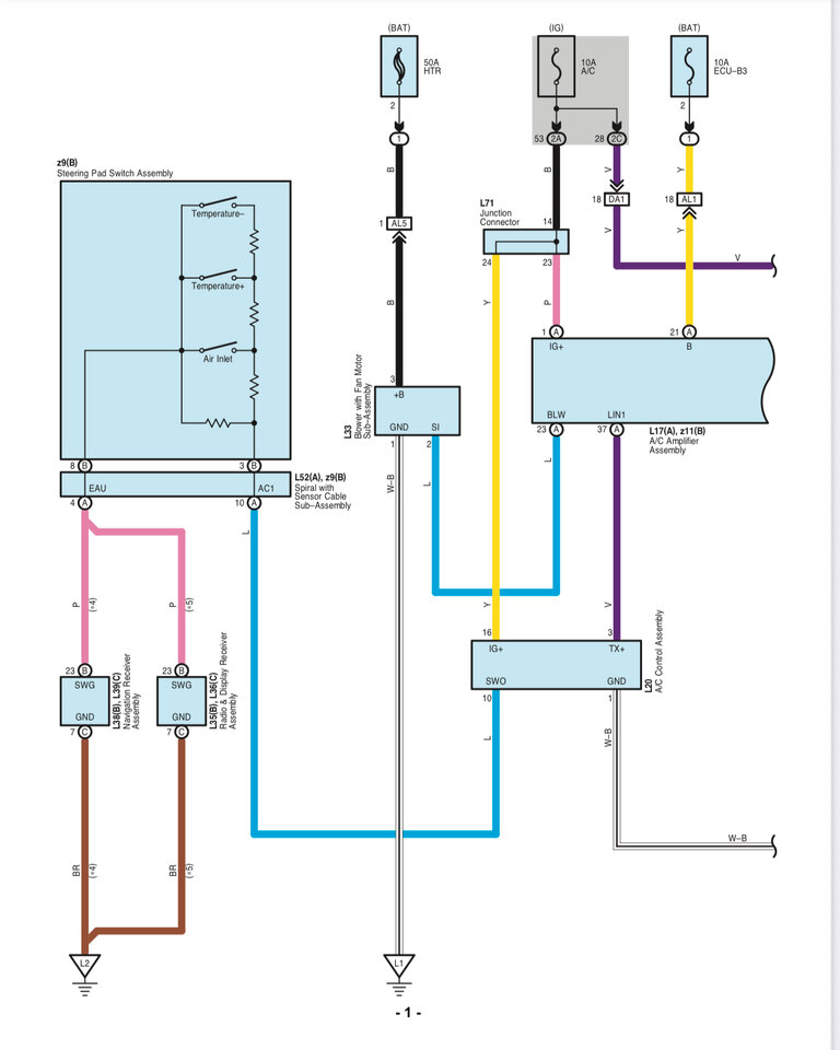

    Which 3 fuses would you check?
  8. Brian1954
    Brian1954 Senior Member
    Jan 31, 2021
    2,657
    1,060
    South Central PA, USA
    The three fuses shown in the electrical schematic (first picture) shown in post #6

    -Techstream only available at dealer
    -I can’t read diagram, which fuse numbers should I check? (Working on phone)

    Click on pic
