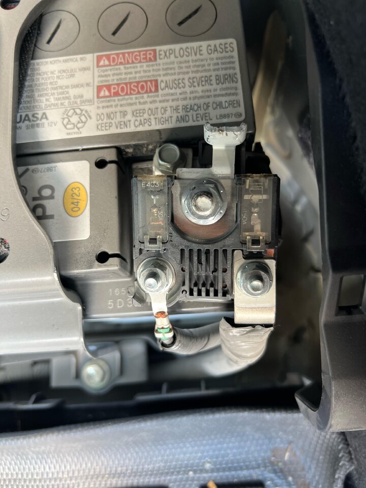

    Just as I said, I blew a fuse on the Negative Battery Terminal. What can I do about it? I have a 2023 Toyota Prius SE. I think its called a "battery Terminal End Link sensor". Can i just replace the fuze? if so. Where do I get one? Or do i have to buy a new unit?

    First off, do you know what caused the fuse to blow and have you corrected the fault?
    If so, the main part you are looking for is:
    82620-47140 - Block Assembly, Fusible Link ($31.32 MSRP)

    Okay. Just checking because so many people want to keep swapping in new fuses when they blow instead of searching for WHY they are blowing.
    The part number is for the whole black plastic section with both fuses. You'll have to remove all three nuts, then swap in the new part.
    And don't worry about being a dumb***. I was right there with you a few weeks ago. I was fixing a friend's hair dryer in my car(long story) and I wanted to test it after the work was done. I had a small inverter in the car, so I figured I'd plug the hair dryer in and see if it worked. Yeah, didn't bother to check wattages/amps. I tried to pull 1800W through a 175W inverter plugged into the 12V power port. And I was confused when the hair dryer and inverter stopped working. lol
    There was a 10A fuse in the inverter and a 10A fuse for the power port under the dash. Guess which one decided to blow?
