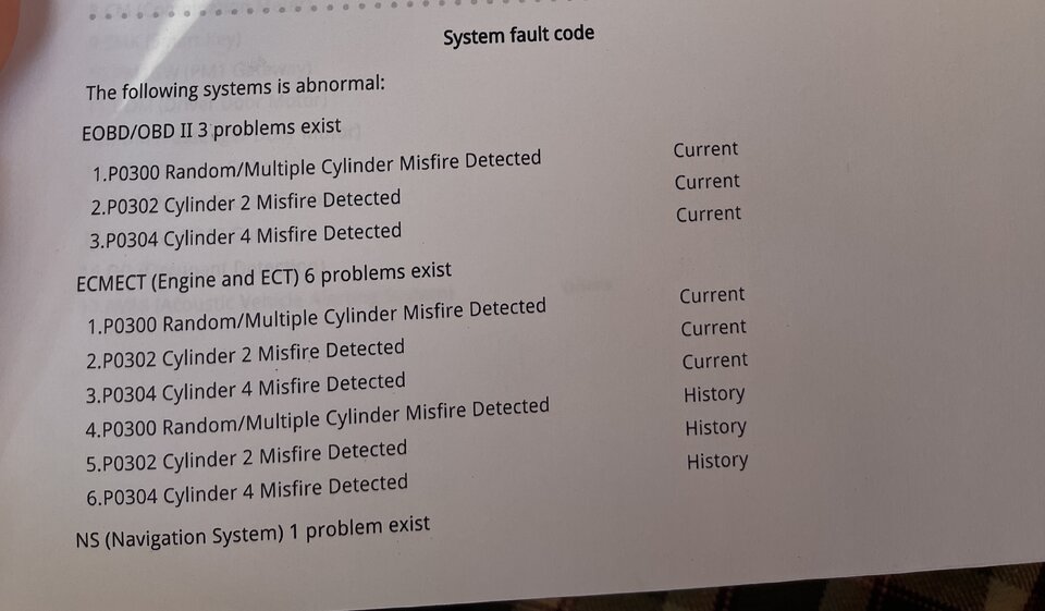

    Hi y’all, just came back from the mechanic and they need to keep it over the weekend and check on it again on Monday. Only this came up.

  10. MAX2
    MAX2 Senior Member
    Aug 12, 2024
    1,436
    490
    101
    Third planet from the Sun
    It is necessary to understand the reasons for misfiring in cylinders 2 and 4. There are many reasons and a thorough diagnostics is necessary, which is done in the same way as on a non-hybrid gasoline car (inspection of the inside of the cylinder, checking spark plugs, ignition coils, fuel pressure, air leaks, injectors, etc.)
