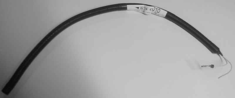

    4,092
    I don't believe so. They had ALL the paperwork! ALLLL OF IT! None of it with any big changes.
    Any/all recalls were done. I need to get it in to get the headlamp harness's replaced. Which I'd rather do myself,
    but I'm sure they won't just give me the parts... :(

    They would not give me the parts to do it myself. The stealership also wanted me to have (buy) all factory bulbs in to do the job. Not sure what IM I have?

    I understand why they have to do it. I just prefer my work because I KNOW it will be done correctly, the first time.

    Well, no, they won't give 'em to you, but they'll sell 'em to you. No different from any other part.
    You need two, plus the proper copper-to-aluminum crimp sleeves and sealant-lined heat shrink tubes, and the correct crimper for the copper-to-aluminum crimp. You don't want to do anything half-@ssed when crimping copper to aluminum. Toyota sells the crimp tool at around $150, but @Elektroingenieur has found it for less.
    More about the repair ended up on this thread, partly because of the Cu-to-Al business.

    You seem to be misreading what I'm writing.
    I know what I need, I know what needs to be done to repair it, I know how to do it.
    A consumer doesn't PAY for something to be replaced or repaired on a defective part. The company does.
    I want to do it myself because I don't trust any of them to do it correctly.
    I wouldn't "crimp" the connectors for a connection exposed to the elements. Inside the car you can get a way with.
    But outside, no. Not even with the sealant. I would solder it. But since they don't get paid to solder it, they won't.
    But I would because that is the RIGHT thing to do.
