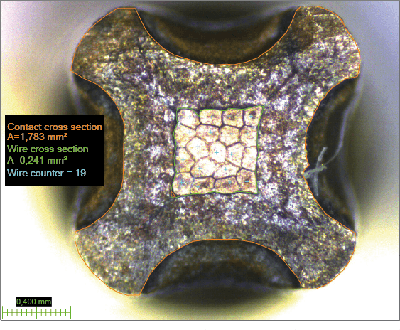

    From the way you have expressed this, it's clear that you think solder makes a better splice than a proper crimp; it's clear from the way you describe crimping as something to "get away with" or something the auto/marine/aviation industries adopted because they don't get paid to solder. You're certainly not alone in those beliefs and I don't expect anything I say to change them. But it's only fair to other readers to give a nod to the arguments on the other side too.
    Solder vs. Crimp is one of those endless internet sports. It is easy to find blog posts and opinion pieces about it. Here's one that's better sourced than many (which is to say, at least it has some sources!), though it's still firmly in the lay internet-guru genre.
    There's so much stuff of that kind on the 'net that it kind of makes the more interesting stuff harder to find. The Air Force likes to know how to make good connections, so Rome Lab had Martin Marietta spend some time looking into that from 1976 to 1978. Some bits and pieces:
    (I kind of glommed together the parts of the table on pages 28 and 29.)
    Solder does stack up darned well too ... it's that 6 score on vibration that seems to account for some of the tilt in favor of crimping in the auto/air/marine worlds.
    -Chap

    Before I knew better, I had many personal bad experiences with solder and vibration. For a time, I used to make homemade external battery packs for my night running headlamp that I'd keep in a pocket (to keep the batteries warm, and to reduce weight carried on my head). The soldered joints, protected with adhesive-lined heat shrink would always fail within a couple weeks of about 2 hours a night of running. The failures were always at the soldered joints due to vibration from the bouncing of a runner's stride. I tried many different homemade methods of strain relief, some working better than others, but a soldered joint would always eventually fail.
    I later learned that crimped joints are the best method for cars because of the vibration issue from watching Mighty Car Mods on youtube, and that made total sense to me based on my experience.

    On most of the information I can find, adding solder to a well-crimped connection, depending on how carefully you do it, can fall anywhere on the scale from "probably harmless" to "combining the least useful properties of both". :)

    "IF" the solder joint in done CORRECTLY, it IS better than a crimp. With a crimp, there is air between the two metals.
    Which is where corrosion comes from, or at least starts. With solder, it can't happen. IF done correctly.
    A cold solder joint will/can corrode, but not a hot joint.
  16. ChapmanF
    28,744
    19,047
    As far as I know, that's mistaken, and that point is basic enough that being mistaken there could explain a lot of other confusion about crimp joints.
    The gas-tightness of the metal-to-metal contact is one of the first properties of crimped connections to be mentioned in any treatment of the subject, for example on p. 11 of the Rome Labs document linked earlier, or, here (or here because the photo is cool).
    -Chap

    Do whatever YOU want. If it makes you FEEL good. I'll stick to what works best so I only
    have to do it once.
    With any crimp, that WILL be air gaps.
    If it makes you FEEL good. Crimp, then solder. OR, solder then crimp.
    As long as you FEEL good.
    Unlesssssssss, You crimp it so HARD under a LOT of pressure that it melts
    the metals so they become one.

    Which you would realize, if you had read even two paragraphs into the "properties of crimp connections" section in that Rome Lab report, is exactly what we're talking about. The term "melts" isn't used there; the terms "metal flow" and "cold weld" are.
    One of the best ways to move technical decision making away from the realm of feeling is by paying attention to what is known about the technical subject.
