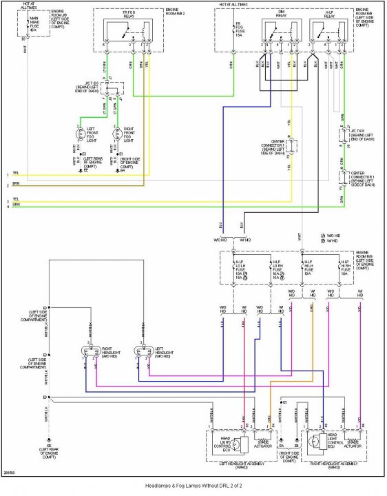

    Though's two fuses operate the shade actuators in the headlamp. It would be most unlikely that they both would go short circuit so I would suggest looking for damaged wiring (possibly mice) under the fuse box. The wires are colored violet and yellow in the circuit bellow. Disconnecting at the headlamp end would be a good starting point to see if the fuses still blow.

    Having read your post again if both fuses are blowing it is difficult to see what could be blowing both fuses.
    I would have thought it most unlikely that both actuators would be short circuit, and as you can see from the circuit the only wires they feed are the yellow and purple one's at the bottom right of the circuit.
    All the other wires in that part of the circuit do not actually exist, only being there with halogen lamps.
