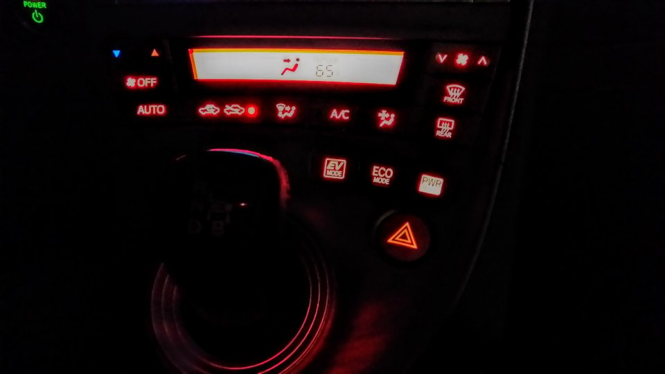

    In my past life I was a helicopter crewman in the Navy. In aircraft and ships we use red lighting at night because it doesn't degrade your night vision and allows you to see outside without being blinded by the glare of your instruments.
    So, that's why I decided to roll with red.

    I am pretty comfortable working with a soldering iron. But I've never ventured into the area of working with surface mount components.
    Wow! This was more difficult than I imagined. This work requires a very steady hand and excellent vision at the very small scale.
    First I started with something easy -- the shifter overhead "mood light".
    This was a pretty straight forward operation. The disassembly, LED replacement, and reassembly were not particularly challenging.
    Next I moved on to the smallest of the surface mount jobs -- the hazard & mode button assembly.
    Here's a look at the circuit board after I removed the OEM LEDs, and made a few other mods.
    Notice that Toyota is using LEDs that have a Cathode lead on three corners (indicated by the "K" pad on the circuit boad). That's a problem for me because the Oznium LEDs simply have a Cathode side and an Anode side. That's why I was forced to bust out the Dremel and etch out the third K pad. That was a problem for EV LED (top left) because that third K pad was also inline with the path to the source voltage. So.. a jumper was necessary.
    Here you can see the finished product. After going through all of this, I buttoned it up and put it in the car. It was completely dark! After rechecking all of my connections with a ohmmeter I thought I'd try reversing the polarity on one of the LEDs. It worked! So ... it turns out that my Oznium LEDs are notched on the Anode, not on the Cathode as I thought was the standard. Yep, just looked it up. It's official.
    (From the Oznium website.)
    That little board with four LEDs took nearly three hours before I could declare success.
    That's why I was nearly ready to quit when I opened up the AC controller module.
    This baby has got 26 LEDs on it. Gawd!
    But I had enough practice by now (and I'd figured out the notch was the Anode) this ended up going very smoothly. After etching out all of the third K terminals, I only needed to add two jumpers. Whew!
