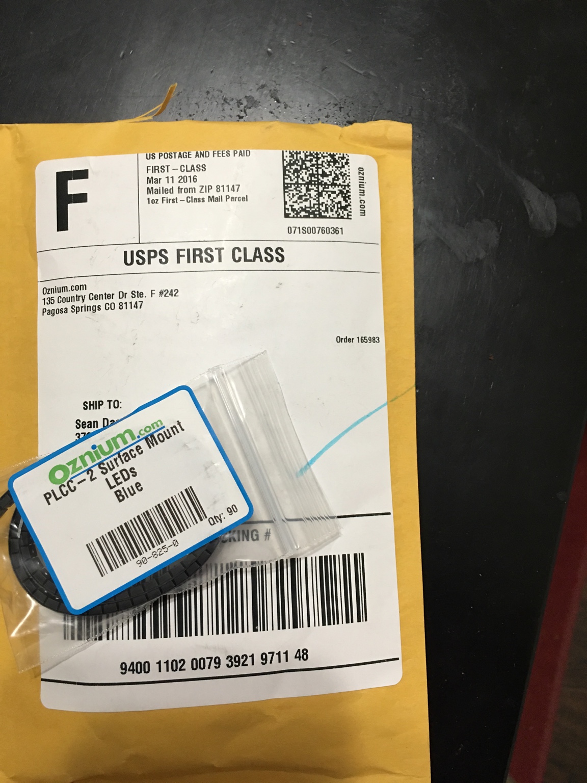

  6. sfv41901
    sfv41901 Masta S
    May 5, 2010
    4,591
    5,293
    Palmdale, Ca
    Gotta pay to play playboy
    iPhone ?
    apt5020 and bonchang like this.
