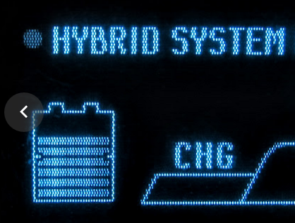

    For retrofitting the instrument cluster ...
    Notice each LED has a letter indicating its OEM color: B, G, R, Y
    The 10 LEDs in the / \ pattern are the white backlight for the steering wheel control display. Then you have the two X patterns which are the amber backlight for the steering wheel control buttons. Then there is the four staggered LEDs for the indicators on the left, and the row of 5 indicators at the top.
    That's a total of 49 LEDs.
    For all of the above, I recommend the Oznium 1206 type LEDs here: 1206 Surface Mount LEDs | Oznium
    For the two VFD (vacuum fluorescent display) modules, the only thing you can do for them is a transparent overlay. I purchased a RoscoLux sample swatchbook on Amazon.
    These Rosco films are used in professional studio photography for flash filters and lighting filters.
    After some experimentation, I found that the "Brilliant Blue" was the best choice.
    It photographs really well. But to the human eye, the blue filtered VFD display still has a greenish hue. I think it's worth experimenting with some other choices.

    I am all game. So many damn leds. My sentra cluster has 3 bulbs lol.
    Will order.
    Btw, you will not get the exact blue because green is a primary and blue is a primary.
    sfv41901, Burna J and Dylan Doxey like this.
