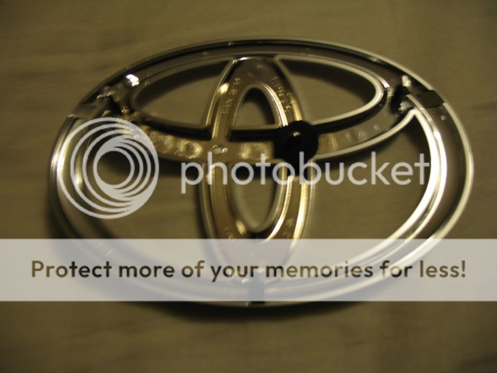

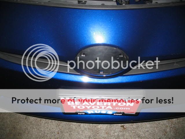

    OK folks, it is your perverbial Good News, Bad News. Which do you want to hear first?

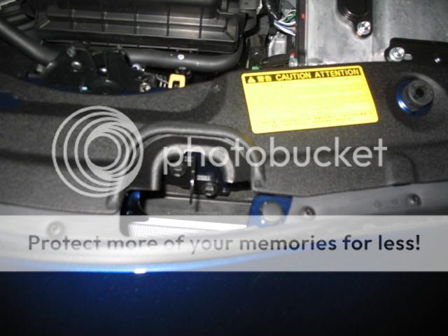

    The good news is that I went out and learned that the emblems can be jiggled. In other words, they are not glued in place. In fact, they are held in place by clips that can be easily released from behind. Back Hatch, you'll have to remove the inside panel, but front, all you need is a skinny wrist to reach through the hood latch opening or remove the plastic panel around the hood latch by releasing two buttons holding it in place.
    But the Bad News.
    No painted body panel under. Just cheap plastic with little bumps all over it.
    Guess the solution is to get a rattle can and paint the plastic insert. High quality rattle cans can be purchased from PaintWorld.com. They blow the doors off of Duplicolor but are about $22 per can. I have a local paint store that will make me a custom rattle can for $19. Maybe I'll go all out and cut a peice of sheet metal to replace the plastic insert.

    The emblem forms the window the radar for the cruise control uses, cover it with metal and I doubt your adaptive cruise will work right, if you have it.
    Maybe you could paint the black plastic part with good prep or put a painted plastic sheet over it, cut to size.
