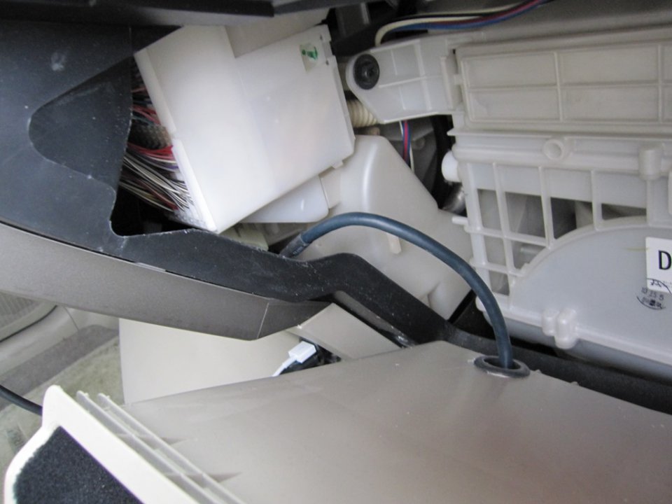

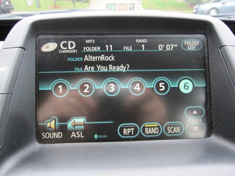

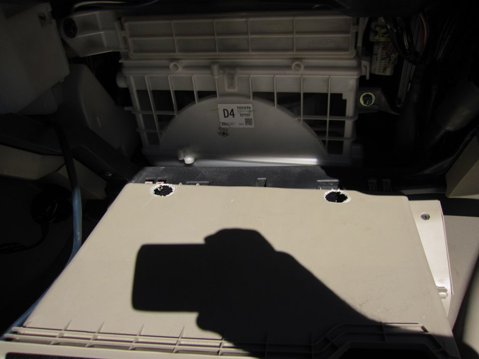

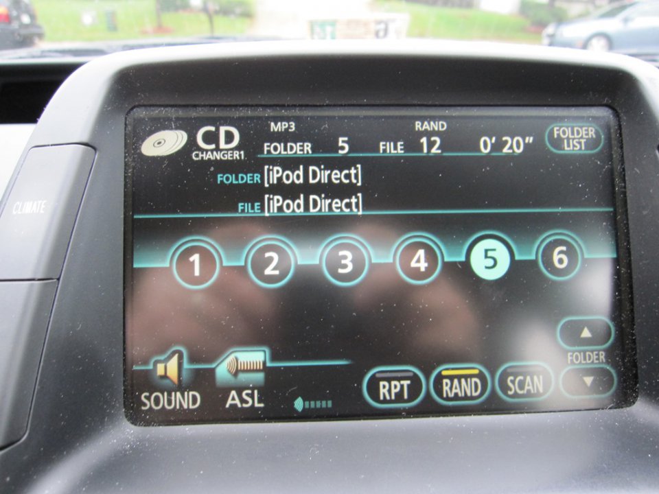

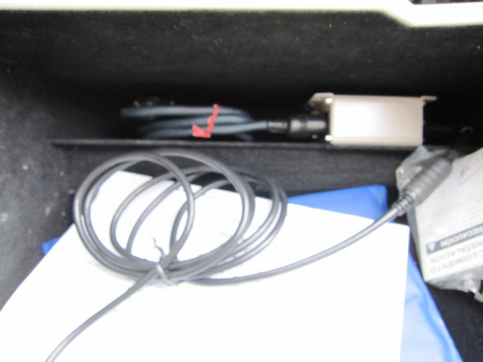

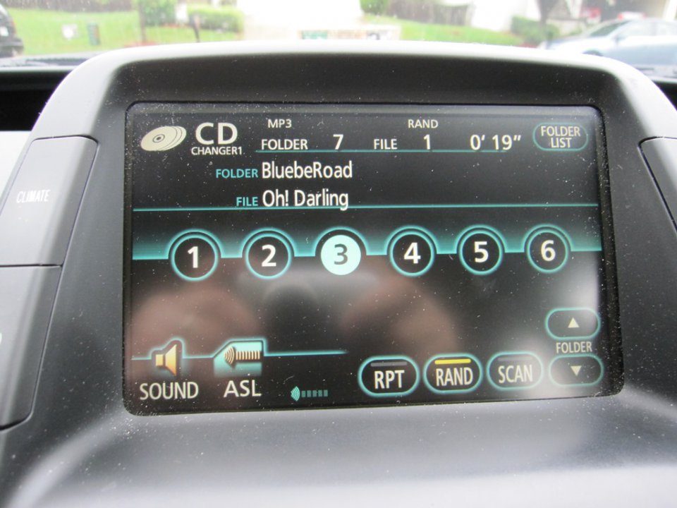

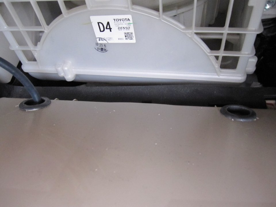

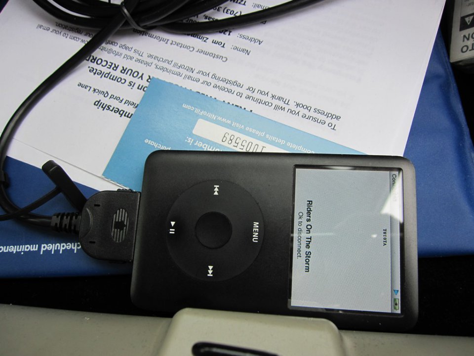

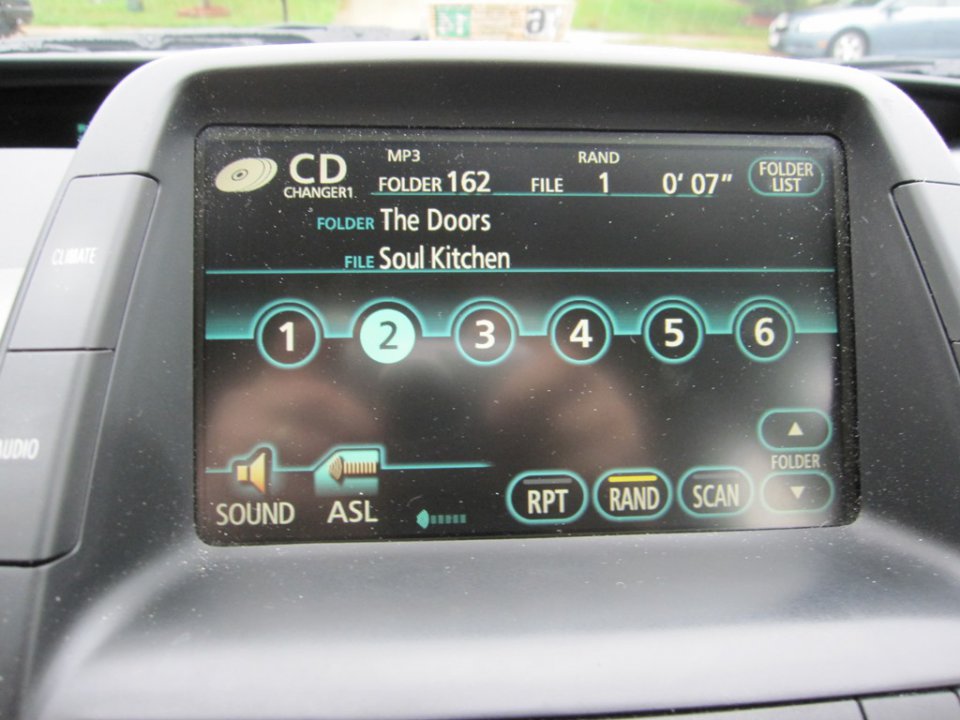

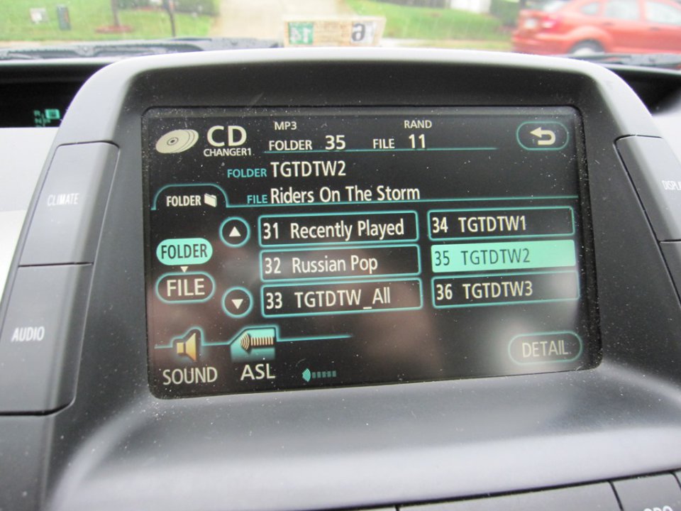

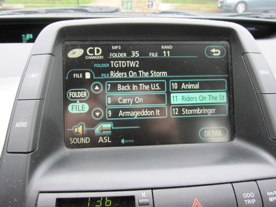

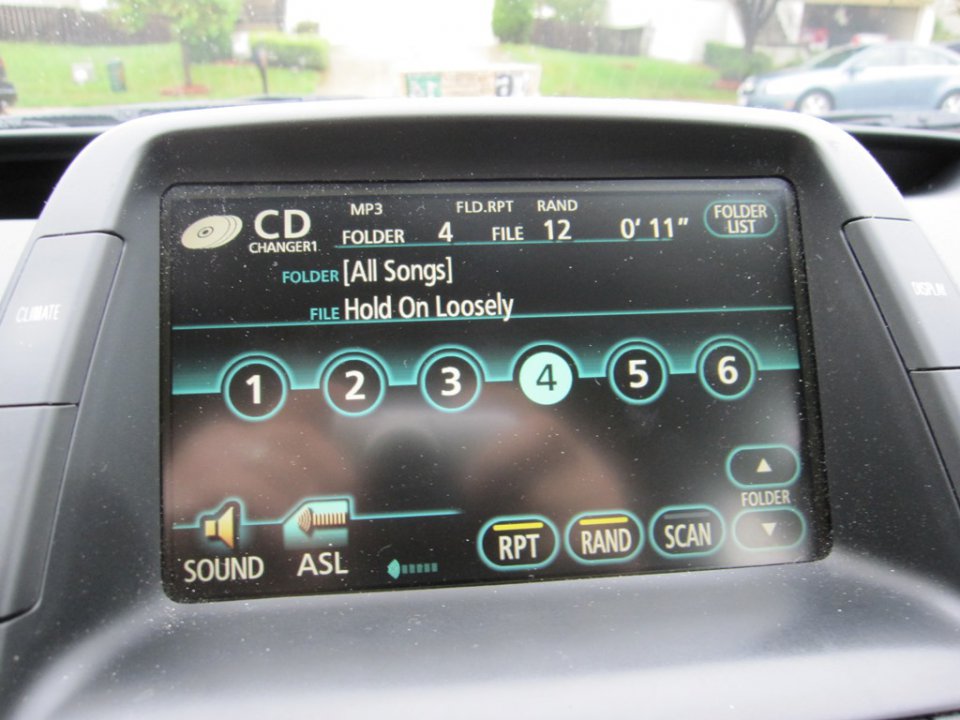

    I have a 2007 Prius with the 6 CD Changer, JBL speakers. I didn't do the Bluetooth, but installed the USA Spec PA20-TOY that just uses the connection for SAT Radio, one plug into the back of the radio for my iPod connection. Only had to remove glove box and right side vent to install. It disables the CD playing (never used it), but has pretty versatile control of iPod in glove box out of sight, steering wheel controls volume, song advance--touch screen changes to next folder, whether it's playlist, artist, album, genre. USA Spec also make a BT35-TOY, that connects you device to car via Bluetooth. I've had great experience and audio quality with the PA20-TOY. Had to drill out the one of the holes in the back of the glove box to 1" diameter to run the cable through and avoid pinching. Did both for future additions. Used a couple 1 & 1/8" rubber grommets from Lowes to finish the hole. Module fits neatly in the compartment in back of glove box. Each of the six CD numbers on touchscreen controls a different function: 1 is Playlist, 2 is Artist, 3 is Album, 4 is ALL Songs on iPod (Don't use that one much), 5 is iPod Direct if you want to run the iPod cable out of glove box and manually control play; 6 is Genre. Some functions are disabled when driving, but still very handy. Screenshots attached.
