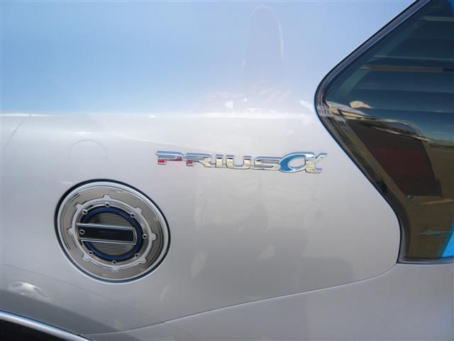

    Cool Prius Alpha badge! :cool:

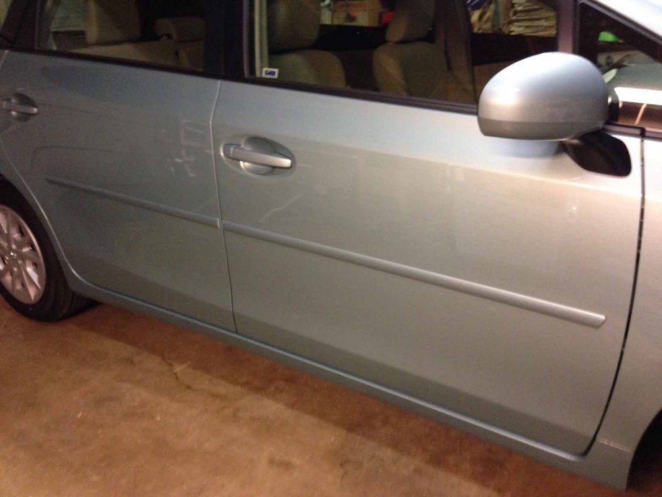

    I successfully installed door moldings that I purchased from Juiced hybrid. It took about two hours since I was working very slowly and carefully. Instructions were clear. The kit includes four moldings (with sticky-strips on the back), two alcohol cleaning pads in sealed packets and two liquid "Pro-Bond" sticks. The paint job on the molding matched the car perfectly. You start by placing a horizontal line of tape to serve as a positioning guide. Then you clean beneath the tape using an alcohol pad, apply the Pro-Bond liquid (smelled like epoxy) and finally stick on the moldings. The end result met my highest expectations. It will have a couple of days to completely set before I take the car out for a drive to a crowded parking lot.
    Installation tips:
    -- Instructions say masking tape. I used painter (blue) tape.
    -- The instructions say temperature is very important (at least 75 degrees) and to use a hair dryer to warm up the surface if too cold.
    -- When applying the Pro-Bond (liquid glue stick), it is very easy to push too hard resulting in the excess dribbling down the door. Keep a rag close at hand. While doing the second side, I put a second strip of tape an inch under the first to catch the dribble. It also better defined the adhesion area.
    -- Make sure you have a lot of light and that your reading glasses are close at hand.

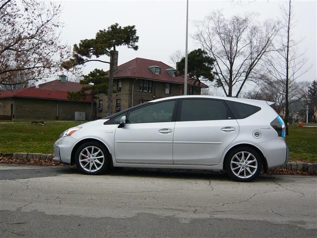

    The side moldings would look sleeker if they were installed with a bit of rake to them. Not perfectly horizontal, but a bit higher in back. Looks good if it parallels the body accent line above it. ;)

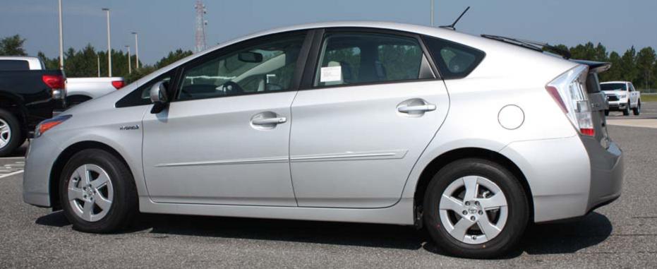

    Then the tapered one will do a better job:
