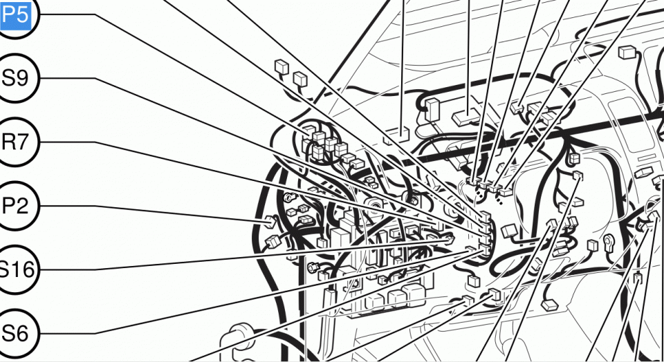

    Have a look at Power Outlet Relay P5 to see if it is OK. Also check the ACC fuses.

    hi i have the same problem, can you send us a diagram to show where relay P5 is located and the acc fuses ? thanks

    For the Gen II Prius, Relay P5 is under the dash on the extreme left side, so it is not easy to get at. Relays are very reliable, so it would be the last thing I would check, after making sure the fuses are OK, and the sockets are OK.
    The fuses are in the driver side block, under the steering wheel and to the left in the U.S. model.
