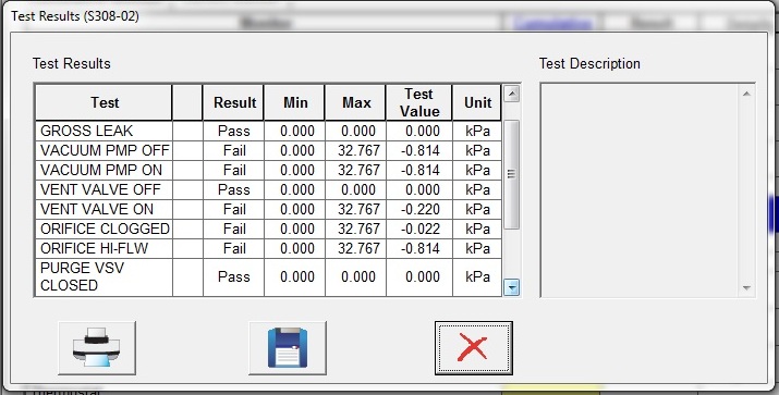

    The last test showed all these codes P043E, P043F, P0441, P2401, P2402 and P2419.
    This is the test the EVAP runs after 5 hrs if the coolant temp is below 95F.
    Why would it show negative values?
    Could it be because the Purge Valve is stuck open?
    I am thinking YES
    EDIT: NO, Just removed the Purge Valve and tried to blow through it, its closed.
    Put 12 volts to it and it opened just as it should, no problem blowing through it.
    Kept blowing air in to it as I removed the 12 volts and it closed and cant get any air through.
    So must I have 2 bad Canister Pump Modules?

    I put the old Canister back in and looks like i am back to the original codes. P043E P043F P2401 P2402 P2419
    So the second can was worst then my hack and glue/taped one LOL.
    That according to the chart below these codes point to just the 0.02 inch orifice being Clogged or hi-flow in the LDP (leak detection pump module aka Vent Valve Assembly)
    Could this be cleaned out?
    Hard to find someone selling just the Module, most places are selling the Entire EVAP Charcoal Canister Assembly.
