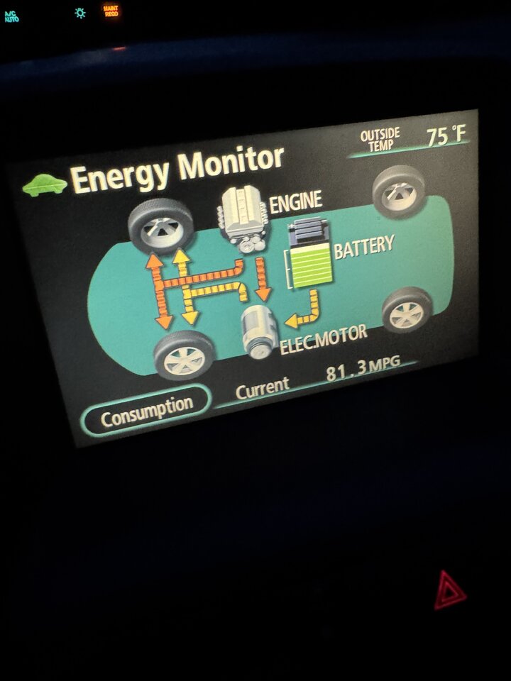

    Ok, well, I take it all back. Tonight I got back out to the car, took off the intake, throttle body, and removed coils and plugs. Plugs look good. Coils aren’t cracked. Plugged it all back in, buttoned it all back up and… I’ll be damned if it doesn’t run almost 100% correctly! They must have put it back together in a hurry and not tightened something or … I don’t know what. Everything was plugged in like it should have been.
    The only issue I have right now is that one of the lines for the EVAP is missing in action, the exhaust leak is causing a P0420 (I think) and a code for the coolant cabin heat switch thingy. And when I came to a stop after a half hour shakedown cruise, the engine didn’t want to shut off, just kind of bounced off idle and loped. I thiiiink that might be the EVAP line though, I don’t think I reconnected that.
