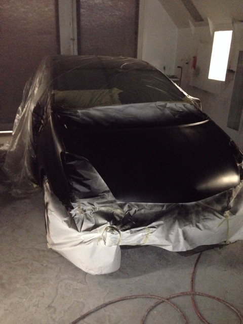

    Post accident alignment update : First I did the control arm. The wheel on the accident side was obviously still way off camber, the top of the wheel tilted inwards quite a bit ( negative camber) . After replacing the strut the camber is only out of spec by 0.1 degrees. I just ordered an eccentric bolt that allows for an extra degree of camber adjustment. This should allow me to adjust the camber right to the center of the spec. As for caster, it is within the specified range but only by 0.1 degrees. I just hope the caster doesn't go out of spec when I adjust the camber with the eccentric bolt. I guess adjusting the caster involves using a frame straightening machine or lengthening the strut mount holes in the body into slots to allow the strut mount location to be moved forward and back. GM cars regularly get these holes filed into slots to adjust caster. Many sports cars come with slots from the factory to adjust the caster. I have never heard of anyone filing the strut mount holes in a Toyota but I don't see why it wouldn't work. I could use a frame straightening rack if needed but I want to avoid the hassle and expense.

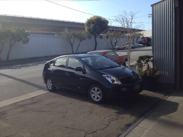

    A little paint and some chinese body parts and this Prius is looking pretty good. Not perfect but I am still pleased with the cost and outcome.
    I still need to pay the dmv. I may need replace one of the front wheel bearings too.
    Overall it is very close to completely repaired and re titled.
