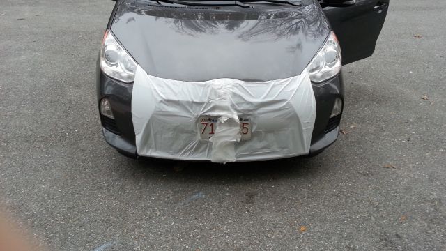

    I am sure others have experimented with other C's with this but after some extreme hypermiling to work RT almost 14 miles RT to work and another stretch of 24 RT stretches,s (I know not a lot of miles) in my PC2 and finally getting some cooler temps here in NewEngland I checked my mileage.
    Summer: 3 trips outside air temps mid 80's: 99 mpg 95 mpg 97 mpg
    Early fall ... temps mid 70's 81 79 82
    Yesterday without modification. temp. 54 62 mpg 64 and 63
    (Modification see below) temp. 54 72 mpg 73 and 72
    I realize other things are affected by the warmth which may increase mileage but the engine turns on a lot less obviously when it is warm out even when the battery is charged. I also had no lights or heater on or A/C when I did these seasonal tests and prewarmed the engine (a few seconds) before starting every RT. I am sure if I had put more miles the difference would have been less as a percentage but blocking the grille must have had an effect as seen. I used kitchen bags taped to bottom and under hood. My wife's (lead foot) mileage mostly highway some back roads has gone from 54mpg to 49. Still very good for her. HERE ARE THE GARBAGE BAGS:

  3. hoarybat
    hoarybat Junior Member
    Jul 8, 2012

    I have a Gen III and was wondering if Toyota placed the inverter in another location on the C? On the Gen III your not suppose to cover up the inverter which resides in the upper open part of the grill. Just checking, I may be off base with the C.

    You drove it like that? :p
    Take that crap off and go to Home Depot for pipe insulation. LOL
    sdtundra, PriusCinBlack and WE0H like this.

    lol I can't believe you drove it like that. :sick:

    very stylish :)
    But interesting result.
  8. hoarybat
    Jul 8, 2012
    LOL only for one day. I'm an engineer so it is function over fashion. Yes I've been planning on using dark grey pipe insulation which matches our color perfectly but before buying I wanted to confirm that blocking would increase mileage. Somehow I now have to slip in the insulation without telling wifey. She frowns upon my experiments! Thanks all...

    Soo... the grille is there to vent. Aren't there circumstances where this will cause overheating and bad consequences?

    Yes, that's why it's done during cool to cold weather and you should be watching temperatures when you do it.
  17. Mendel Leisk
    54,882
    38,345
    With the regular Prius one guru cautions against full block of the upper, since the inverter radiator is there. Until you know what's what I'd be inclined to keep some open on both top and bottom. The inverter radiator would be full width but with short vert. dimensions, say around 4".
