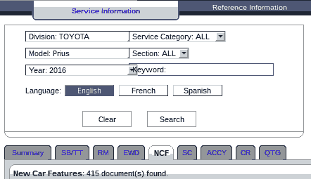

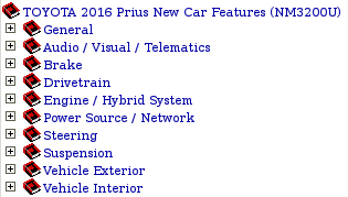

  17. ChapmanF
    28,725
    19,025
    I missed this back when you first posted it.
    I don't understand what trouble you might have had with the hyperlinks; in my experience, they all work and go exactly where you'd think they'd go.
    The times the hyperlinks don't work is when somebody has signed into techinfo and saved a bunch of print-to-pdf, and then shares the pdf file around; naturally in the printed-to-pdf files, the things that were originally hyperlinks are still blue, but they're not links and don't go anywhere. Whenever I'm signed into techinfo, I've always had the links work just fine.
    As for not-set-up-in-a-linear-fashion, I've touched on that before in some other posts on how to get around in techinfo. It's true that the first part of the system you see after signing in is set up like a search engine, and it gives you a list of search hits in the manual in some weird order based on your search terms, more like Google than a structured table of contents:
    The "aha!" thing to remember is to just go ahead and click any of the results from the manual you want to peruse. Any of 'em, it just doesn't matter; pick one.
    Once you have opened up any page in the manual you're interested in, that page will have a regular, tree-structured, linear ordered table of contents on the left, and now you can flip through that just as you would a paper manual.
    -Chap
