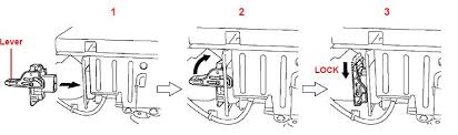

    Post #46 shows you that the orange traction switch lever has to be slid down to lock it in place. Did you do that?
    That DTC points to a fault in the installation of that orange switch lever, or the inverter cover was not correctly installed, as a interlock switch is located below the cover.
    Since you had to mess with both interlocks, there is a high likelihood that one or the other is causing this particular problem (additional problems might also be present.)

    Found the culprit of the DTC code: the little plug on the inverter cover got bent during installation. Fixed that, and my car is running!!! All the lights are gone. No DTC. Sounds great! Here I was checking the orange plug a million times when the inverter plug was the issue.
