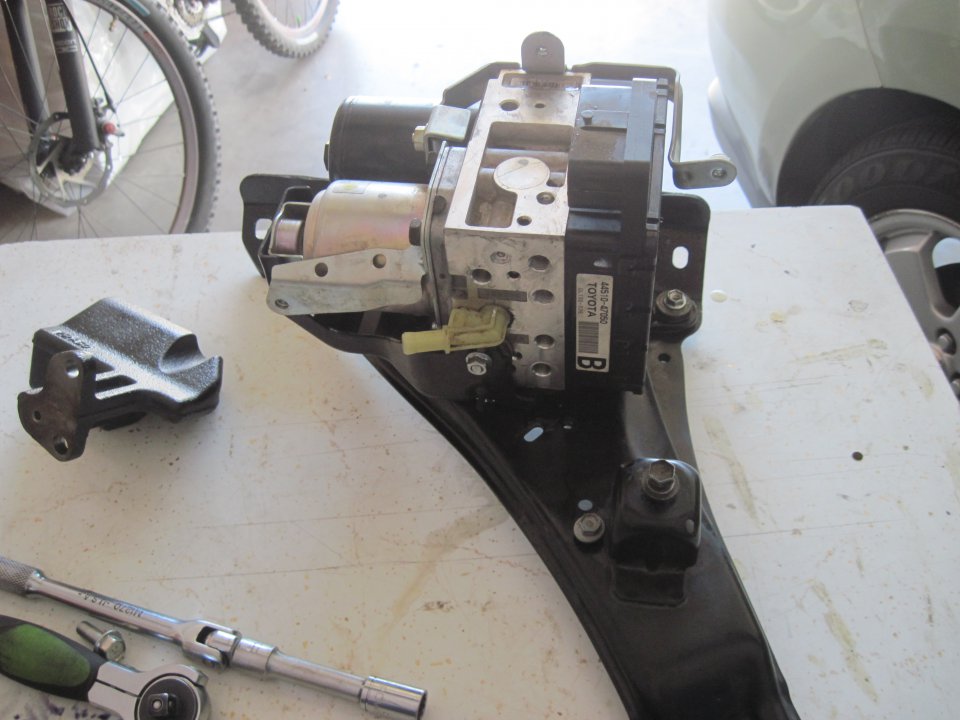

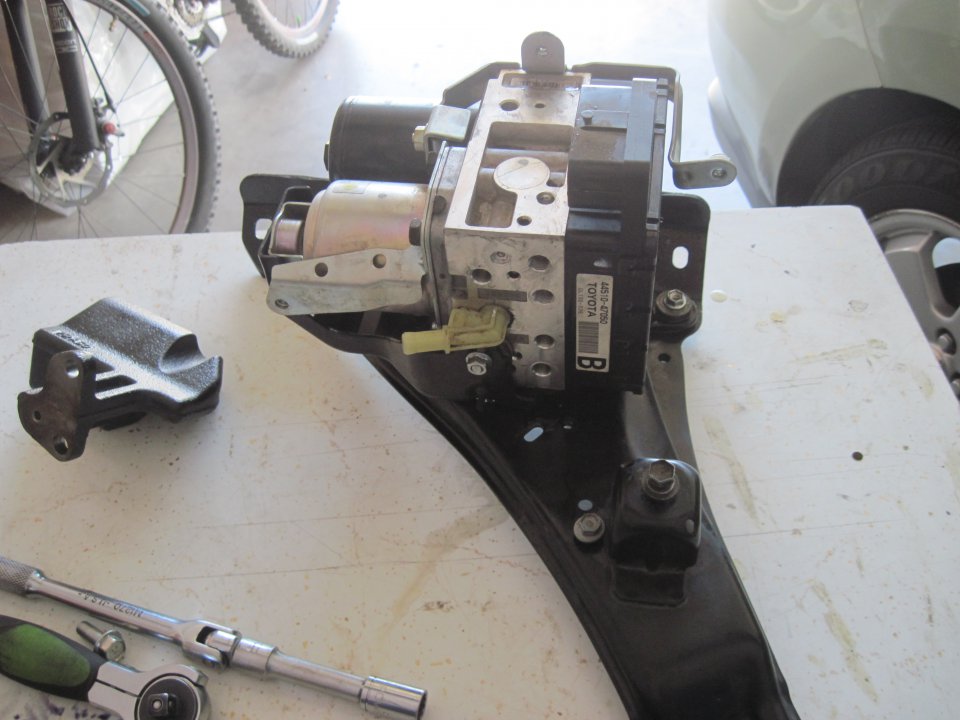

    My mechanic replaced the actuator assembly due to its continuously turning on every 30 sec for 2 sec. The new actuator hardly ever turn on. The brake feels more firm, probably due to bleeding the brake as part of the actuator replacement task. The associated resistor in the dash was accessed from below with some difficulty.

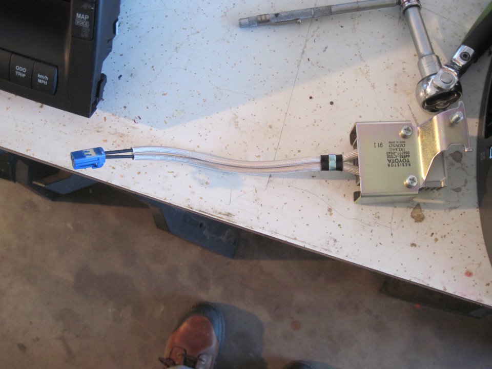

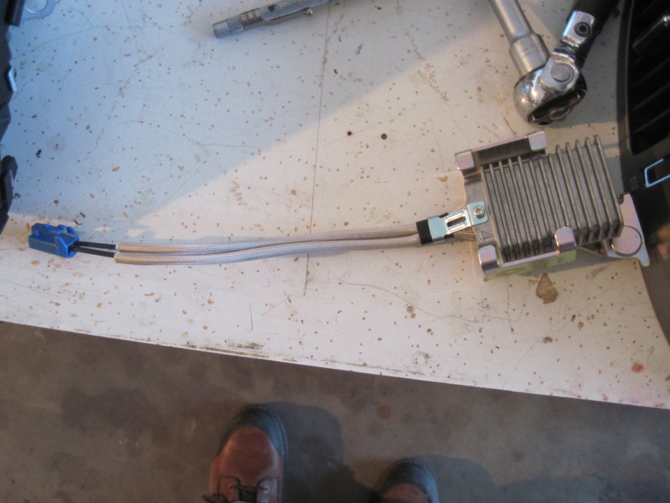

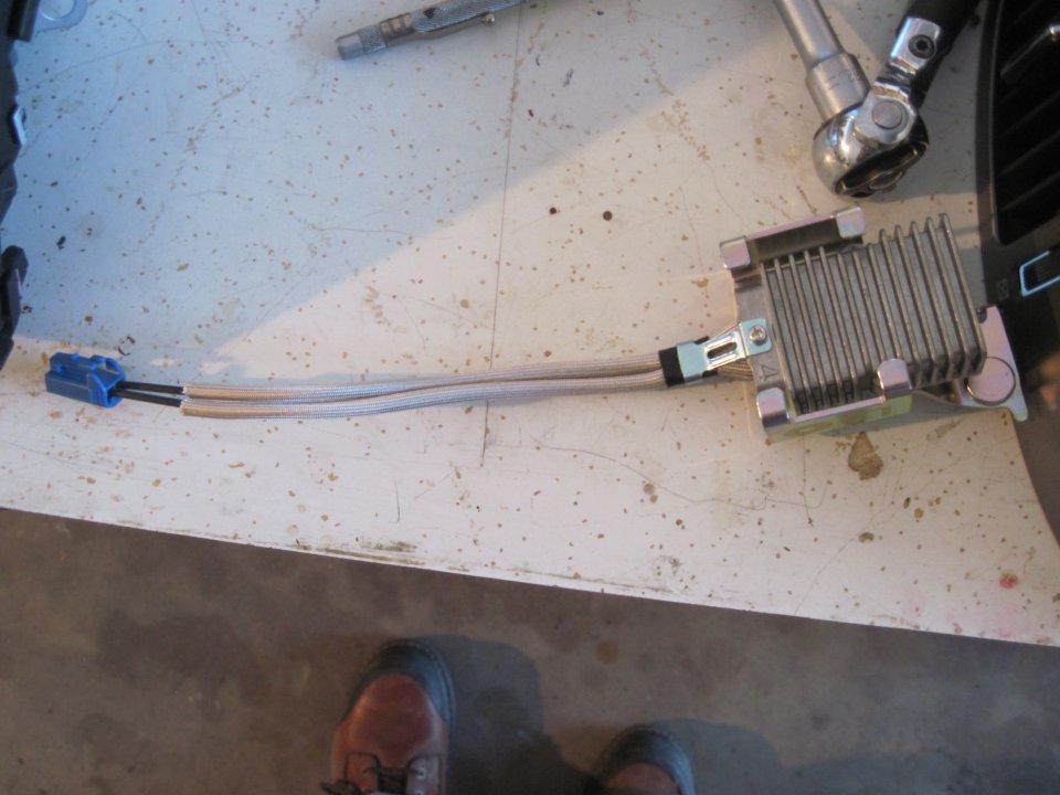

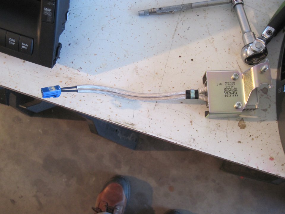

  8. Avi's Advanced Automotive
    Avi's Advanced Automotive Independent hybrid repair shop
    Jun 28, 2012
    776
    363
    Is this a picture of the old actuator and new resistor? If so, I'm pretty sure both resistors are the same value.
  9. nh7o
    nh7o Off grid since 1980
    Dec 10, 2011
    1,686
    340
    Hawaii
    The value of 193.6 milli-ohm is interesting. That is a very precise spec for a resistor. With all the heat fins, it would look to be something like 25-50 watts. If so, I would guess about 10-15A of current flow through it @ 12V. I find it hard to imagine what would be the requirement for such precision in a DC motor. In theory, it should be possible to measure the old resistor, and determine if it is indeed necessary to replace it when replacing the pump. In practice, it takes some doing to measure low values with accuracy. OTOH that is a pretty simple plug fitting, which will have it's own small variation in resistance, especially over time, so again the precision does not make sense.
