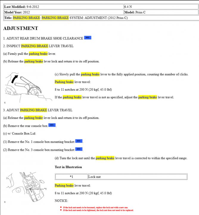

    I've found that many drum brake systems could use a turn or two of the adjuster wheel at every scheduled service. The "c" uses a conventional drum brake system, so I think it's a legitimate service.
    One way to tell whether the rear drums need adjustment, is to see how many clicks are needed to fully engage the parking brake. If it is more than 5-6 clicks, your rear drums can benefit from a minor adjustment. Lastly, self-adjusters are rarely found to be as effective as advertised.

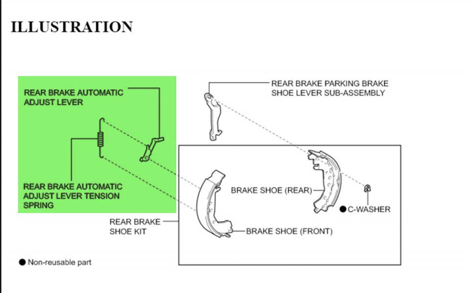

    I have attached a diagram of the rear shoe setup on the C, so have a look at the design. Then,
    no one can tell you lie's at will :ROFLMAO:
    The statement about checking brake adjustment with the parking brake is somewhat correct, but
    it can also be a misleading test. Always use the self adjusters first. Then you can follow this
    procedure to check your parking brake for proper adjustment.
