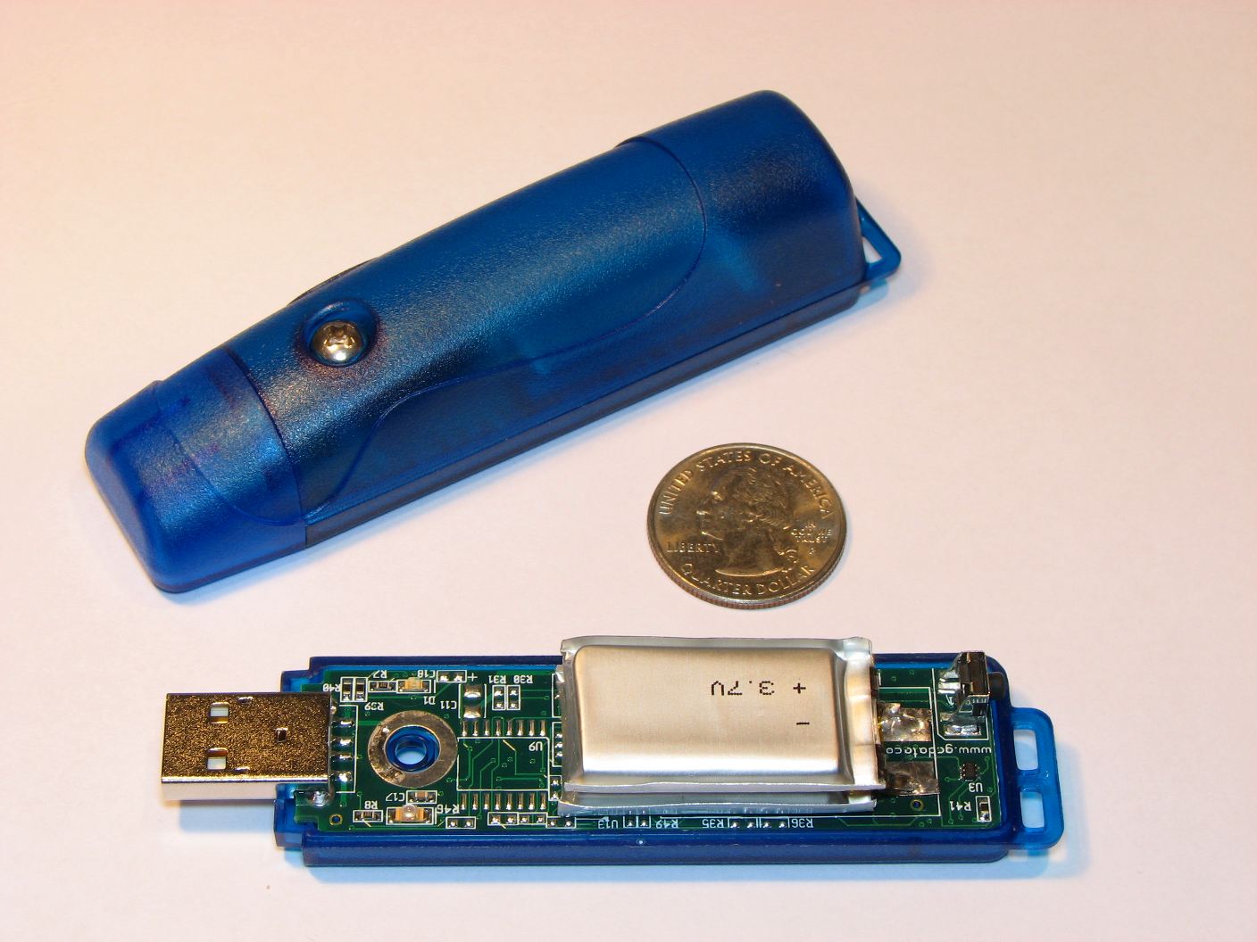

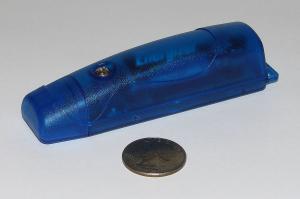

    Fortunately, I've found and ordered instrumentation to gather engineering data:
    This unit has a high resolution, 320 Hz, sampling interval and built-in, rechargeable battery.
    This unit has a sampling rate of 160 Hz and uses a removable battery. This is the unit I'll "loan" to those who can replicate the problem.

    But first, let's document the braking anomaly. Having hard, empirical data, we can absolutely know what is going on and in a month or so, nail down what is going on. Combined with a GPS recorded track, we'll be in high cotton.
