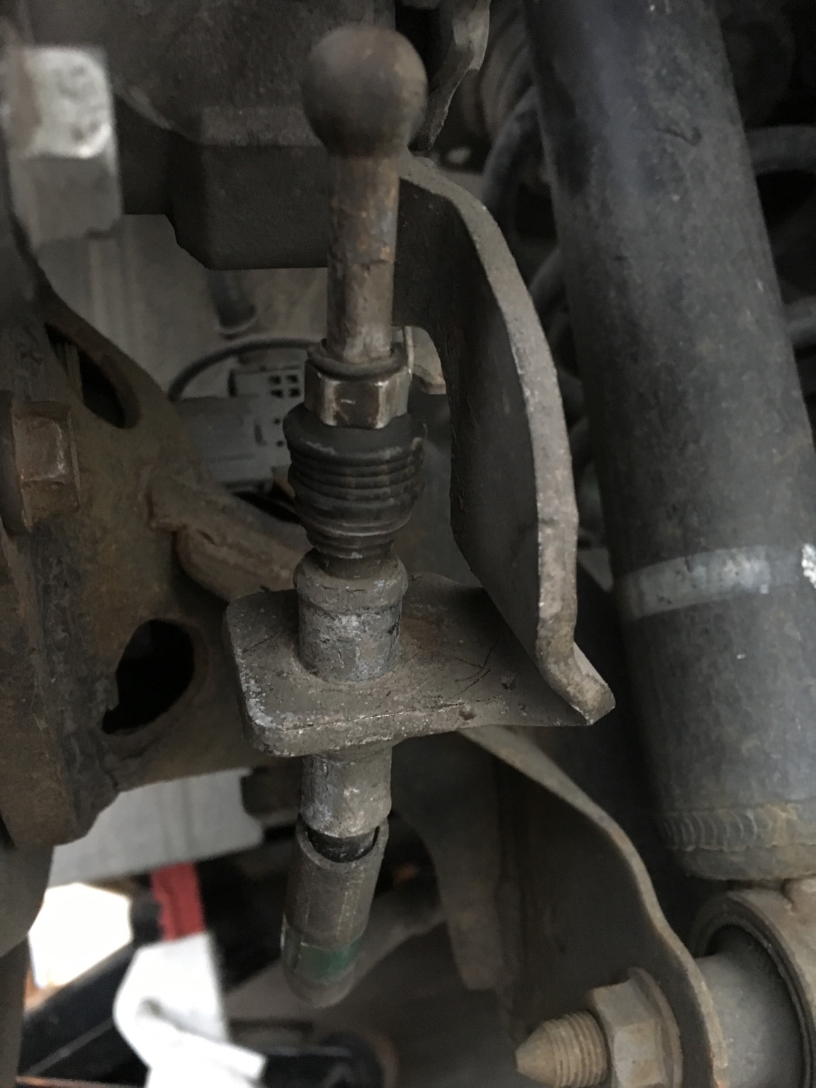

    Project stalled due to not being able to remove parking brake cable from caliper
    iPhone ?

  14. Jimi1976
    Jimi1976 Active Member
    May 15, 2013
    242
    124

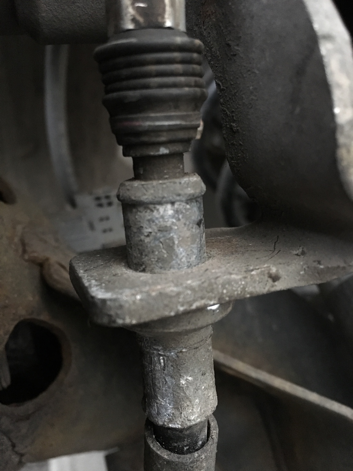

    Denver, CO
    I've got plenty of slack....even have the ball end removed.
    Can't get it removed from where the cable assembly mounts to a mounting bracket/hole on the caliper assembly
    iPhone ?
  15. Mendel Leisk
    61,529
    42,343
    Not sure if this helps. I'll attach the whole pdf on brakes too.
    Ah, I think I see what happens: as you push down with the wrench it compresses tangs on the clip, allows the cable to slip thru?
  16. Jimi1976
    May 15, 2013
    242
    124
    Denver, CO
    Definitely helps - thanks!
    However - I had that clip totally removed. Cable assembly wouldn't budge
    iPhone ?
  17. Mendel Leisk
    61,529
    42,343
    Maybe someone will chime in if you post a pic?
  18. Jimi1976
    May 15, 2013
    242
    124
    Denver, CO
    iPhone ?
    Gonna soak it with PB and hit it with some heat
    iPhone ?
  19. Jimi1976
    May 15, 2013
    242
    124
    Denver, CO
    She broke loose after 2 cycles of MAP heat
    iPhone ?
