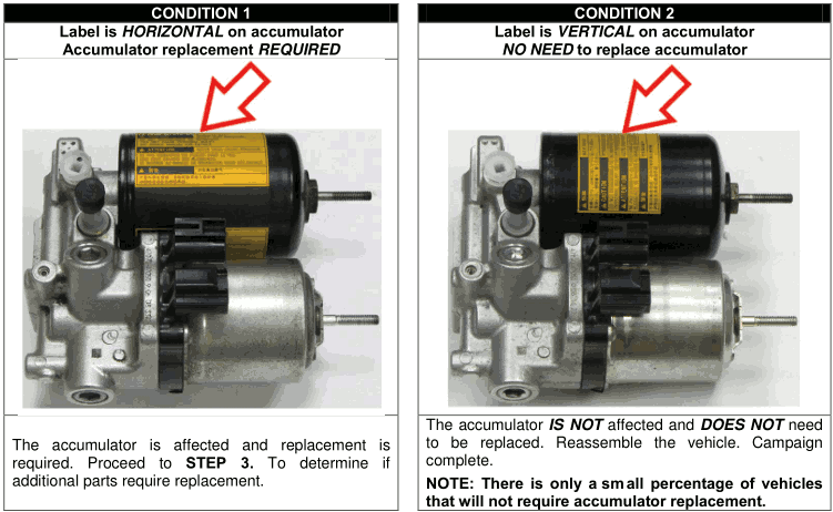

  7. Mendel Leisk
    61,529

  10. Mendel Leisk
    61,529
    42,343
    There’s something in the Toyota doc’s I linked, regarding the orientation of a label on the barrel of the Brake Booster Pump Assembly (Accumulator): after fixing something in the design, subsequent built pumps have the label rotated 90 degrees, compared to older design.
    Seems a funky way to identify the change, maybe subject to subterfuge: could unscrupulous seller peel off and rotate label??
  11. ChapmanF
    28,720
    19,019
    The bad batch of accumulators only went into some 2010s, so it's probably not super likely to run into those these days. I doubt anybody's going to the trouble to peel and restick labels. I was concerned at one time when it seemed like some of the sketchy ones were just turning up on eBay, in label-unrotated glory.
    The metal bellows inside the accumulator can had been made slightly undersize, so they would bang about inside the can in bumpy driving, and develop cracks earlier than expected.
    For accumulators built in later model years after that bad batch, I'm not sure the label orientation tells you anything.

    The cylinder is leaking internally. You gotta replace the parts in tandem. You can see the label without removing any parts. Look at the attached photos. My booster pump is used and had an extremely short warranty from a local junkyard. It looks like the correct orientation of the label but who knows.
