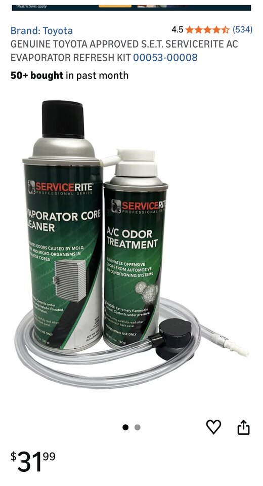

    Mr. Mendel, I gave my 3013 to our son - it's running GREAT with new head gasket & new brake booster & master cyl. I bought a 2017 ECO2 from a friend and it STINKS like dead animal - I think it might be mildew in a/c. How much cleaner fluid can i inject from below into the drain hose ? maybe 2 quarts before it will spill into the 'cabin' ?

    No I don't think that air box will take two quarts before it starts running out on the floor might get close though.

    Remove the cabin filter and ensure no major buildup exists. Leave it out and inject half a can of evaporator foam cleaner from below into the condensate drain line. Let the foam liquefy and drain out. Repeat with remaining half. It works.
    No harsh central ac cleaners or damage can occur.
    No need to turn off ac three blocks away as some suggest.
