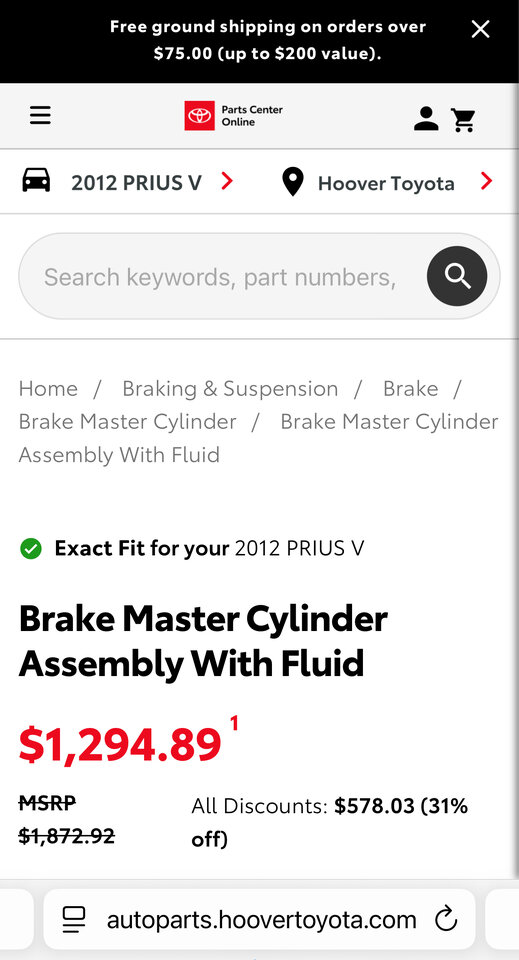

    My VIN is in the screenshot, plus I entered the Campaign part numbers so they are an exact match for 2012-2014 Prius v wagon. So the pumps arent the problem? It must be an internal failure of the master cylinder?

    This is the Customer Support Program or CSP from Toyota, now expired for this vehicle due to mileage and time. The part numbers are in there, it says to use the Campaign part numbers.

    Looks like the same part as a "kit". Sometimes a kit supplies a gasket and can have a lower markup on the price.
