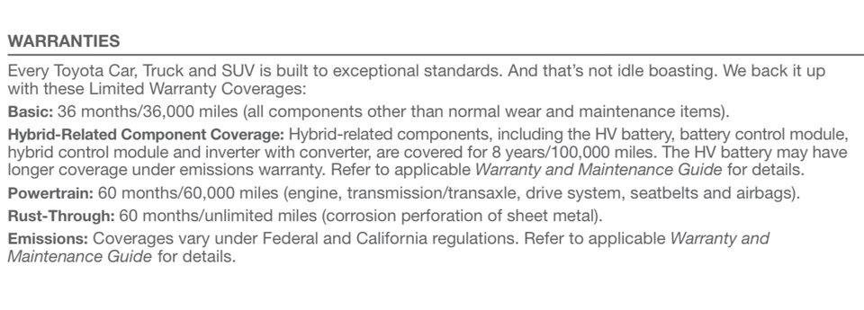

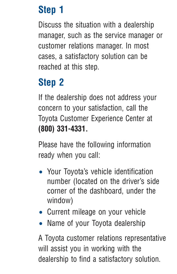

    You could contact Toyota Corporate but it will be a waste of time on a 14 year old 190k car. Their 10 year 150k warranty on this system was already extended from the factory 3 year 36k mile warranty.
