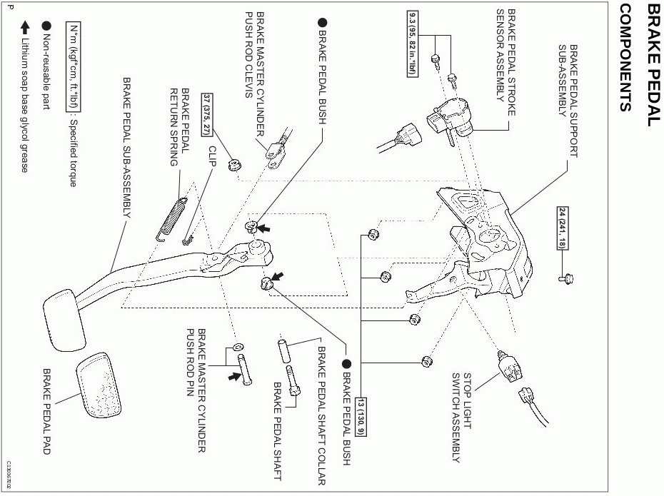

    I wouldn't say the whole dash, but a good bit of it. That is mostly pop together fittings, and can be DIY. Plenty of guides here and youtube to help get the dash off. Here is a look at the pedal mechanism. It might be possible to get to it from below, but it would require a bit of the contortionist act, a long tube on the lubricant, a flashlight, and a mirror.
    exbauer likes this.

    Thanks for the diagram. I'll have to give it a go and report my finding. My A/C blend servo might need to be replaced. So, hopefully they can take care of it when they replace it.
