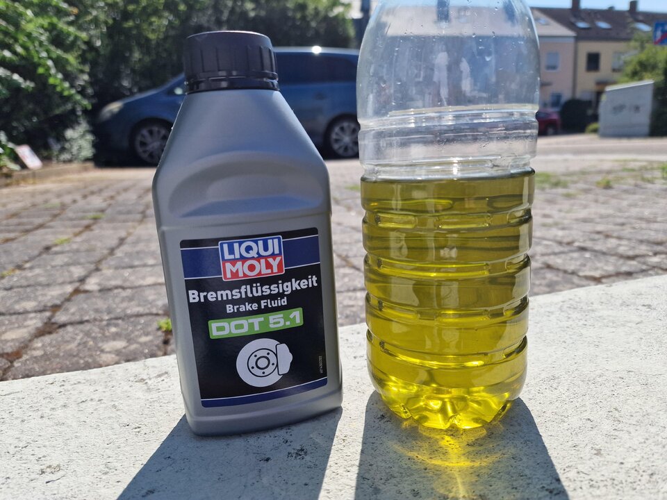

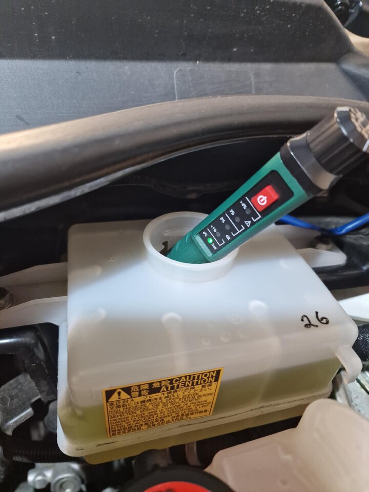

    I did exactly like what CarCareNuts does using suction pump. It takes about 10 minutes taking the fluid from the reservoir and 10 minutes on each wheel. The 8y old fluid is still clear and amber <1% moisture. Probably, hybrid owner only need fluid change every 20y.

    I was confused how Toyota scheduled maintenance is defined. In the US, sparkplugs 120k miles/10y, in Europe 5y/60k miles, brake fluid every 2 years (Wth), and TPMS must work or MOT fail. When I told my neighbor, my brake fluid is 8y old, and he was freak out. I told him, the brake fluid is still like new, better than your 1y old VW brake fluid.
