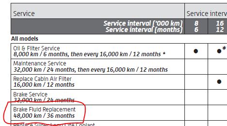

    This is in the Canadian 2014 Owner's Manual Supplement (has the maintenance schedule):
    FuelMiser likes this.
