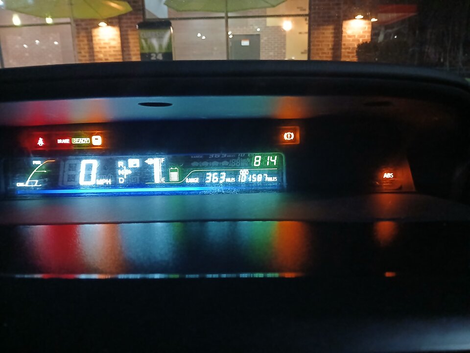

    Good evening, all
    I have a 2013 Prius V (pretty sure it is just the Base) with ~ 101,587 miles. I drove to the store and everything was fine. When I got in and started my 2013 Prius V, the brake indicators (Brake, ABS, (!), SS) on the dash were on. I did not notice until after I started driving, so I pulled into the gas station next door. I checked the book. I confirmed that the brake fluid level is between the min and max lines. The emergency brake is disengaged.
    Reluctantly, I drove home. It was only a few miles and I took all back roads.
    A couple things I noticed.
    I would push on the brake one time and it would be pretty soft. After releasing and pushing again, the brake was again solid. After driving for a few seconds, it would replicate. The first press of the brake was always softer than the 2nd/3rd/etc.
    Every 3 seconds, I heard a very faint "brrrrr" coming from the floor around my left foot/knee.
    Any idea what could be wrong? I am fairly handy (changed radiators, brakes, shocks). Is this something you think would be a straight forward fix?
    Thanks!!

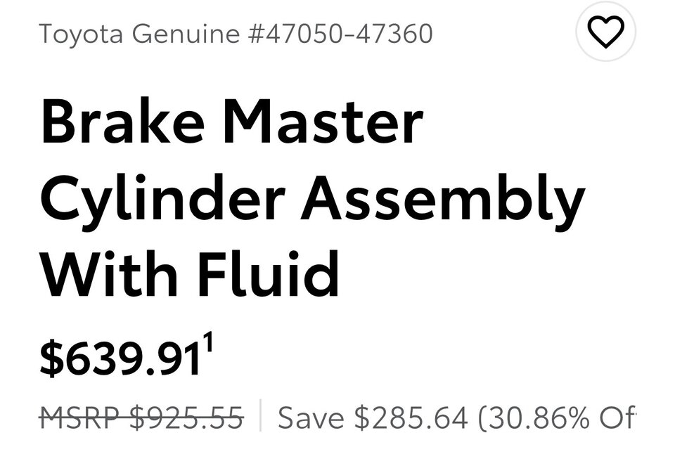

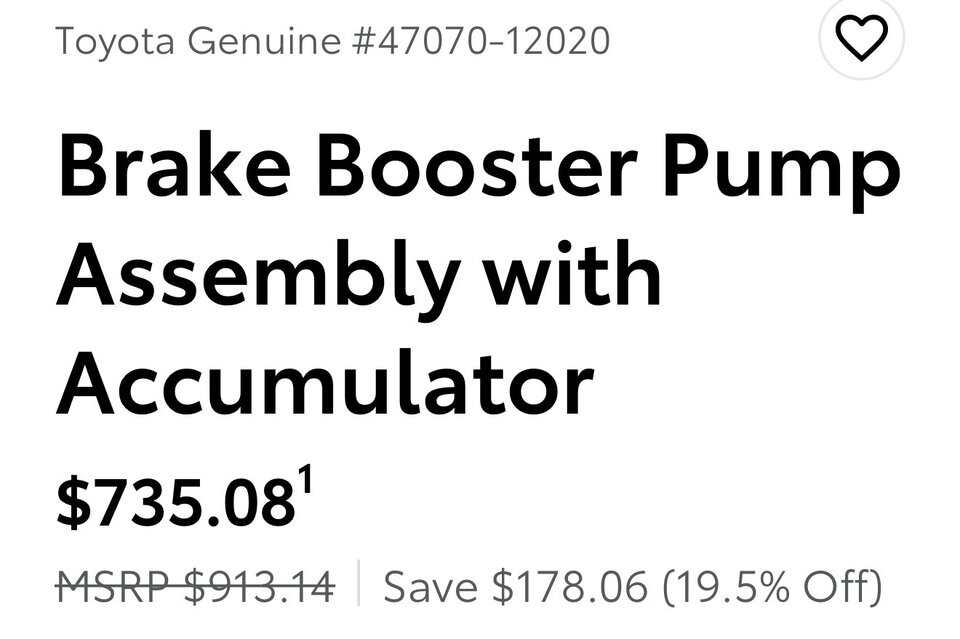

    First having a dealer change both parts is easy and comes with a guarantee. For many that is worth an upcharge of 100% on parts and 50% on labor.
    For me $4500 is too much but to do better, you have to buy the right parts at discount (online Toyota dealers), wait a week and locate a hybrid shop that will let you supply parts (even though they get similar discounts).
    The first is what most people have installed along with a gasket.
    Even if you buy both and pay a shop five hours at $200 an hour you are looking at ~$1400 for parts and $1000 in labor. $2400 and everybody is making good money.
    PS. Last week we had a guy upgrade his gen2 brake booster with a new Toyota part for $800 installed. $500 for the brake booster (he received an additional nationwide holiday discount) and $300 labor at an independent shop. A gen2 is one part and is slightly easier.
