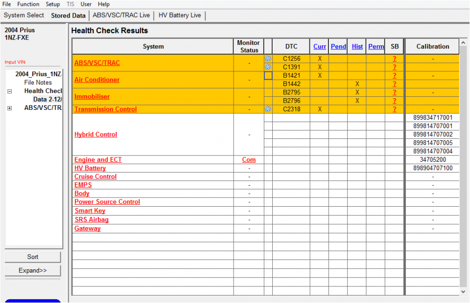

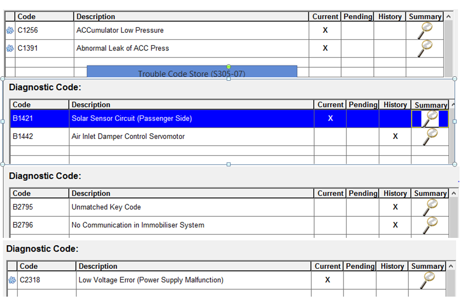

    Thanks for the reply I will check the battery as you suggested ASAP. Here are codes I pull from techstream,
    When I cleared the light yesterday I drove to work ~ 35 min and no lights, went to lunch ~10 min drive and was half way home ~15 min before lights came back on.

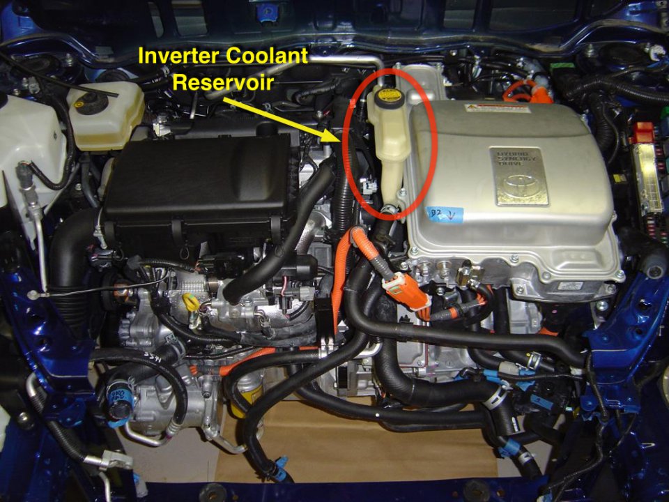

    How so I check the inverter reservoir. Do I remove cap and have someone hit the breaks/gas while peeking in? Im not sure if that sounds stupid, Im just wondering how others have checked it and if they did it solo

    The inverter coolant pump will run whenever the Prius is IG-ON or READY. So just make the car READY and look at the reservoir. If you don't see fluid turbulence then either the coolant pump is not running or air remains in that system.

    Just in case you are not sure where the inverter coolant reservoir is here is a pic:

    I didnt charge the battery but it was at 12.49V before install. The old one was at 12.39 when I had it removed. Looking at the previous battery, it looked fined. I dont know if you looked at the picture I sent with the codes but I hooked up an OBD2 scanner at autozone and I got the same codes:
    C1256 Accumulator Low pressure
    C1391 Abnormal leak of ACC pressure.
    A couple times when I turn the car on I get a long solid beep noise. After reading around and trying to figure out what the hell an accumulator is I found my answer and a very scary 1k$ repair cost and I dont think that is with labor, just parts

    Yes I looked your Techstream images, and that is why I got you to focus on the 12V battery first. The Bxxxx codes can be ignored for now as they will not be contributing to your warning lights.
    So are the C1256 and C1391 the only codes now? If they are then that is good and they are probably what you need to concentrate on. $1,000 is not too bad for a problem of this nature.

    1. I agree that your 12V battery needs to be fully-charged now. Upon installation, the new battery was at 50% discharge. A new fully-charged AGM battery should measure 13.0V. A discharged battery will measure around 12V.
    2. However, the low battery voltage is not the cause of C1256 and C1391. Yes, the brake actuator assembly needs to be replaced.

    Excellent thread... Especially, Dolj posted the picture with text described the Inverter Reservoir... This is how we have documents in High Tech places. Thanks
