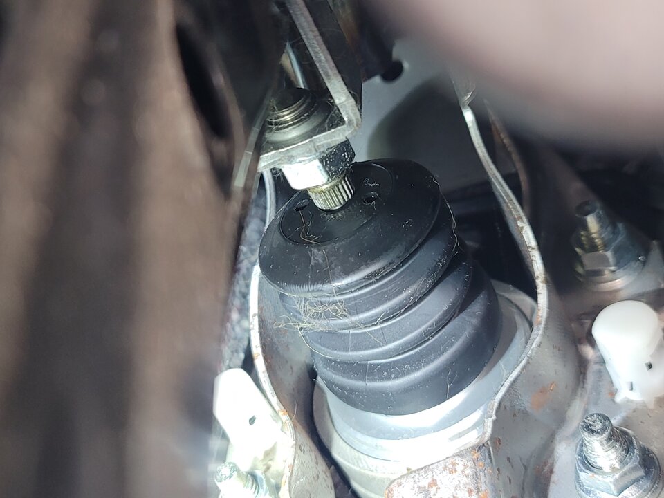

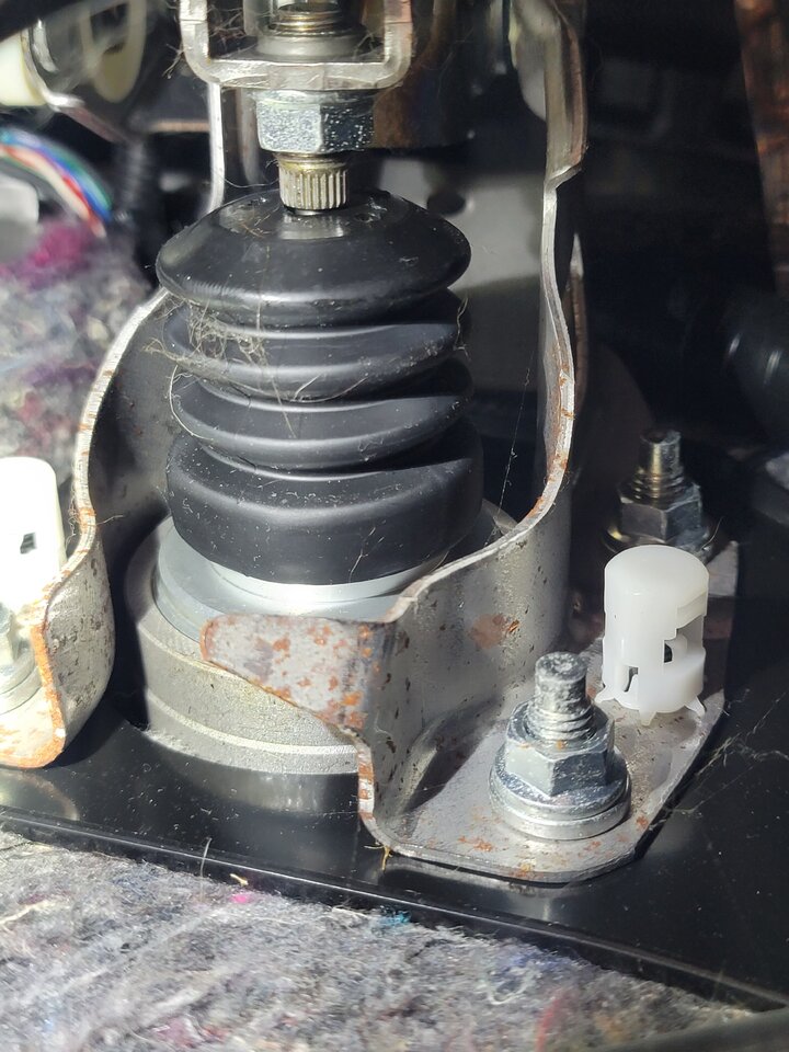

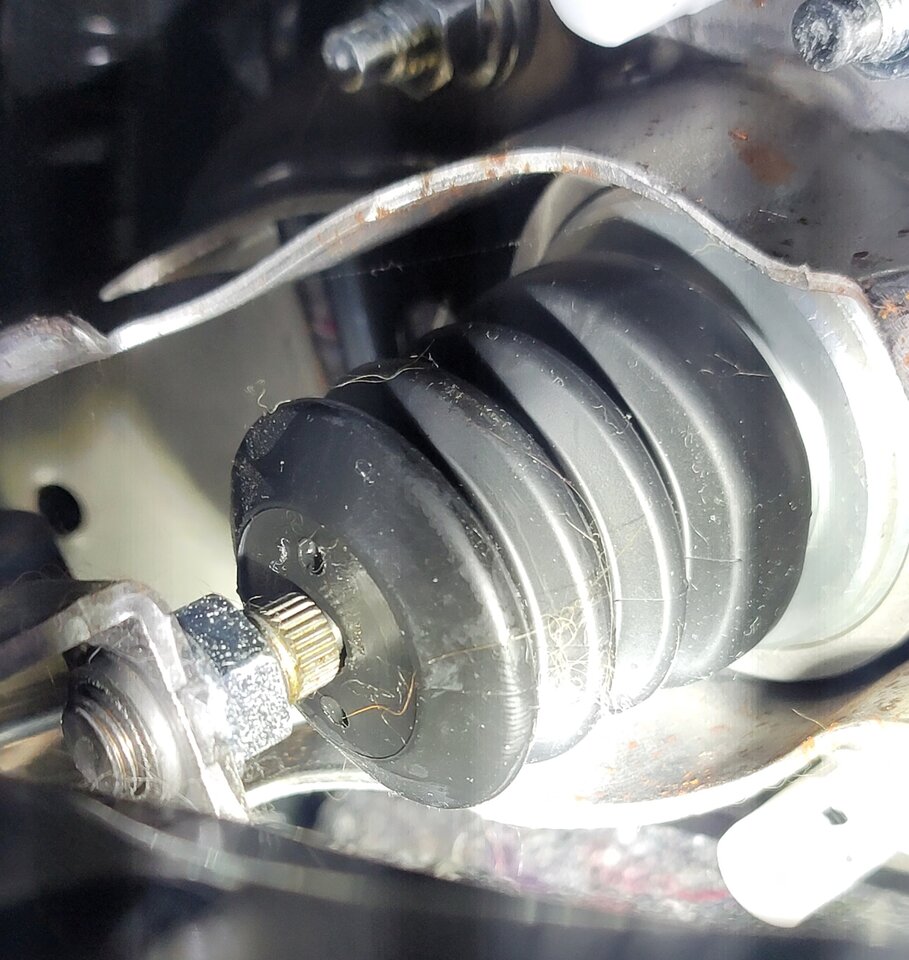

    Today the brake pedal on my roommate's 2017 started making this squeaking sound. It looks like maybe a bit of fluid is weeping out?
    Google Drive link to mp4 video with audio [LINK]
    (Caution: video has an unintentional flickering effect in the lighting)
    Is it an easy fix, or anything to even be concerned about?

    I drove the 2017 the other day and it's still having issues with squeaking and puffing sounds, only it appears to be louder than before.
    Mary I have a suggestion where I could I start for diagnosing this? :censored:

    Disclaimer: I haven't listened to your video. Just speaking in general, it's not super common for the pedal or boot to squeak, but you can get some other sounds like chirp / squeak / puff sounds, as you mention in your later descriptions. Those have a different cause. If you do a search here for threads containing "saxophone reed" (just trust me on this) you should get some relevant info.

    Looking around though, I'm not thinking it's that?
    The issue seems to be physically at the pedal itself, and sounds closer to a small rubber squeaky duck; similar both in the squeaking and the puffing sounds.
