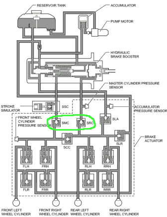

    The two solenoid valves circled in green here are normally open when you are not using the brakes. That open position is their fail-safe position in case the brake computer isn't functioning. In that fail-safe position, the two chambers of the master cylinder act directly to brake the two pairs of wheels.
    Whenever you press the brake pedal and the computer is functioning, the first thing it does is switch those two solenoids to the closed position (as shown here). That closes off the two direct fail-safe fluid paths, so the brake computer is in control of fluid to the brakes on the path involving SLA, SLR, and SCC.
    That click you hear at the very top of the pedal stroke is those two solenoid valves closing. So it's really two clicks, but simultaneous, so they sound like just one.
    (It took me until just last December to finally figure that out, in this post.)
