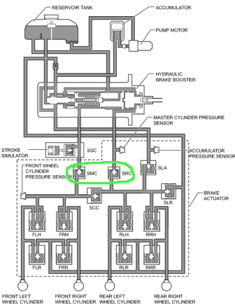

    I have neither; I have a gen 3. But anyway, in my gen 3 there is always a definite click right near the beginning of pressing the pedal, and in my gen 3 it is the sound of these two valves closing in the brake actuator:
    Those are the valves that make the difference between 'normal' brake operation (when they are closed) and 'fail-safe' operation (when they are open).
    Sometimes people talk about the fail-safe mode as needing some valves to switch over before it can work, but as the clicks in the gen 3 show, those valves are in their fail-safe position all the time except when the system closes them for normal operation as you actually brake. That way, if the system were to fail, nothing would have to flip those valves; they'd already be in the fail-safe position.
    I don't know how much of that translates to the brake system in whatever-you're-driving ... there was a little more discussion here.

  10. ChapmanF
    28,582
    18,919
    I think 'release' might have been auto-incorrected from 'relay'.
    Where there is a relay that turns on the brake lights, it is not always mechanical, and does not always make a sound.
    It was my first assumption about the click in my gen 3; it was only after I looked at reflections behind the car and realized the brake lights did not coincide with the sound that I knew I'd have to explore further, and learned it was the sound of the SMC and SRC solenoid valves switching.
