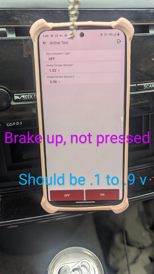

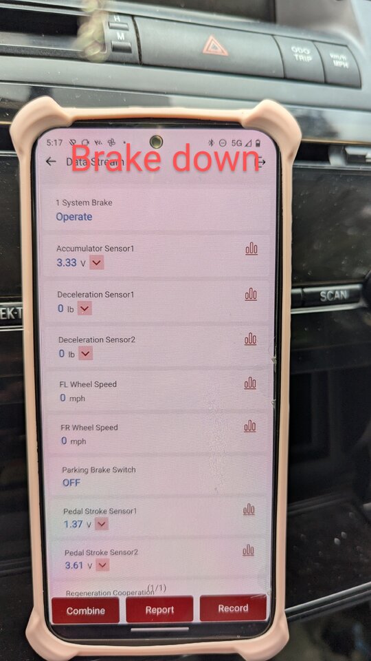

    So I was able to find the live data. I got the voltages to 0.72 and 4.18. I really couldn't do any better than that.

    I'm a new owner of an 05... My 12v was bad when I bought It and all the brake lights were on. I bought an actuator ending with a 0 and had it thrown on for $200, after I paid for the repair I did some research only to find that these parts were recalled... I have now bought another actuator that ends In the number 1, I've had the abs lights come back on Twice... I realized he probably didn't do the linear valve reset and ordered the thinkdiag OBD2, I did the reset and had brakes for over 100 miles that felt normal... My new actuator will be put on on Tuesday and he IS doing an abs bleed, I will do a linear valve reset myself, even if he does one I'll feel more comfortable adding the 2min procedure. Now I'm running some numbers in my thinkdiag and it appears there's a ton I had no idea about that this obd let's me see... I'm uploading a file of the testing I did, pressed and not pressed. Any guidance is appreciated
