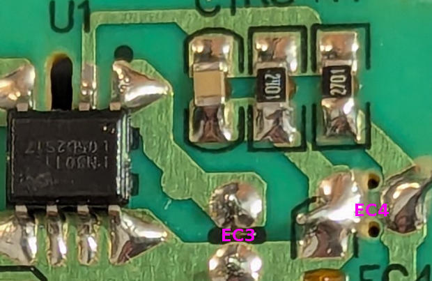

    Got any hints on identifying U1 in this beauty? I was honestly unable to get any better photo of the numbers. If I could identify it well enough to find a datasheet it'd probably answer a lot of my questions.
    Nothing from a Prius. :) This is in a transformerless SMPS with grounded 120 VAC input and 5 VDC output where (to the best my crossed eyes can tell me) the 5 VDC output trace is the input 120 VAC hot trace. (So, though I haven't gone and confirmed this on a scope, so help me the output must be a "5 VDC" trace that looks just like 120 Vrms relative to ground, and a "DC GND" trace that looks the same but with a −5V DC offset.)
    How many have you seen like that over the decades, I wonder? (In biomed, I'm guessing someone would put the kibosh on that.)

    I haven't seen that configuration before, but U1 to the left is the controller/supervisor and I would look at EC3 & EC4 to make sure their working properly. Actually EC4 looks like it's missing. That's actually a good picture. There was once a day when I could clearly read those IC identifiers with my naked eyeball - Not any more.:(
    If you got a schematic, find something you can identify and follow traces. Lots of manufacturers are 'scrubbing' IC- and board- identifiers location to make it even more difficult for people like me to repair them. Whomever is messing with that board, need to refine their soldering skills a bit. Putting too much heat on those 'chip IC' will fry them.
    Sorry I couldn't be more help....

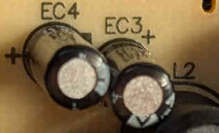

    I think there must have been a production change. There is a silk-screened place for EC4 on the foil side (complete with a dollop of goo to hold it in place for soldering), but the other side is also silk-screened for a regular radial electrolytic mounted thru-hole, and that's where they put it.
    I'm not sure how they ever thought they'd fit any SMD cap that size on the foil side ... there's no extra room beneath where the board mounts.
    No schematic. I'm lucky the board is silk-screened as clearly as it is. This is an Instant Pot—a popular kitchen appliance like an automated pressure cooker with also slow-cook and baking and sous vide programs. All the programs and UI are on another board. This board is just the power supply, the relay and relay driver for the heating element, and connectors and signal conditioning for the various sensors. The manufacturer doesn't sell any internal replacement parts, even this board, which would require no special skill to replace. Their answer is discard the unit and buy another.
    Which I can partly sympathize with, at a $100-ish price point. I've clearly spent more than that in time just taking pictures of the board. And I understand that the way it's built for economy would make some other repairs, like the pressure switches, difficult to carry out and calibrate in the field, with potential liability. But this board poses no such challenge.
    Just galls me to throw out a whole otherwise-faultless unit for what may just be a tired cap....
    Um, none of that's been messed with yet. That's factory. :)
    Right now, the supply makes a steady 4.99 to 5.00 VDC (on a meter; I haven't scoped it to look at ripple) when the UI is awake and the backlight is on. Drops to 4.97ish when the heat relay pulls in. But when the UI sleeps and backlight turns off, the output rises to 5.18 and the circuit makes a trilling sound. Comes right back down to 5 and silent if you wake up the UI.
